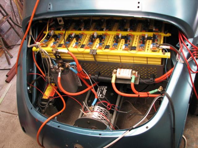

Someone in Hungary has given the Xantia a go with an electric conversion, but no nice pics, just the work in progress, and the vital statistics on the installation
http://www.evalbum.com/4499
The lastest post was from 2015....
2015.06 The 11 Coll motor killed by overspeed in 1st gear :(.
New 9" motor mounting project is in progress.
Not sure if that is a very wide elastic band for the motor mounting on the left of the pic or something a little stiffer :-D

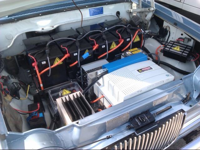

That Xantia conversion looks interesting Neil... The motor is driving the original BE3 gearbox by the looks of it... The Xantia in question was originally a VSX or Exclusive by the looks of it going by the centre Hydractive sphere...
I'll be interested to see how he drives a hydraulic pump...
Posts: 26425
Re: Electric cars/vans/bikes-Conversions/Secondhand..etc
CitroJim wrote:That Xantia conversion looks interesting Neil... The motor is driving the original BE3 gearbox by the looks of it... The Xantia in question was originally a VSX or Exclusive by the looks of it going by the centre Hydractive sphere...
The hydraulic pump for suspension,servo brake, and the servo steering originally were driven by belt from ICE. Nowan auxiliary permanent magnet DC motor is used. Brushed DC motor (from treadmill). It is 180V 3LE at 4000 RPM. The belt gear is 11:6 having enough torque for 175 Bar pressure(tested an worked from 24V).
I think it looks very much like a proper DIY job using old motors from a Forklift and a treadmill as components and a well used car!.

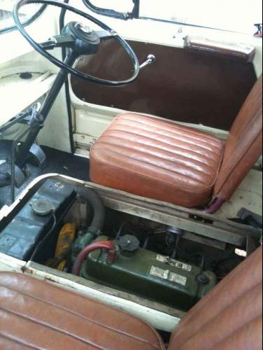

Yes I agree with that, I like a quirky van. Now this looks like a before conversion pic

Heres the link for the details on what was put into the Singer (although down under it was badged a "Humber") Vogue
http://www.evalbum.com/3884
