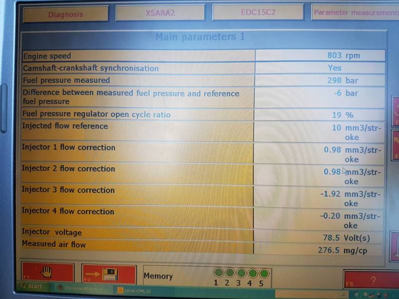

Agree that the injectors should probably be looked at. I'm no expert at HDi systems, so someone else will advise here.
Might be worth running a strong dose of injector cleaner - Miller's Diesel Power Plus or Wynn's Diesel Treatment - through the system. Add to fuel at 1:200 for an emergency clean, 1:1000 for preventative use.
I assume you're not using supermarket fuel?

Hmm. What does Lexia say the coolant temperature is, Simon, when cold and compared to actual?
