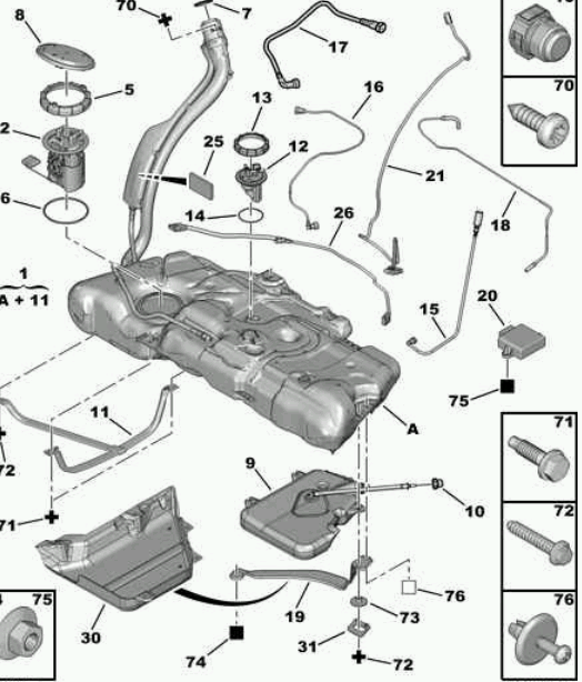

thank you all btw - where is that ECU located?
Simon
x 6956
Re: C5 DPF fault
It's part 20 on the diagram, so should be in the vicinity - bolted on with a Nut.

and part 20 is actually in the drivers side sill!

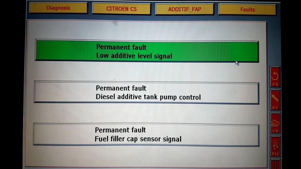

So , the first fault is now cleared - am left with the next 2? But , under lexia I can undo the fuel cap and lexia tells me if I take it off or not?
also how quiet is the additive injector pump?

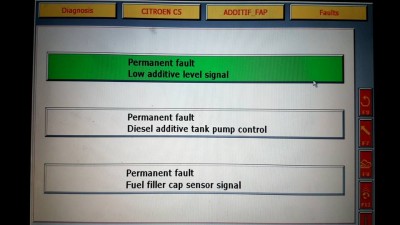

So a bump - anti pollution fault came back - now cleared but I'm still left with the fuel filler cap sensor and the low additive signal. Now, lexia can tell me when I remove the capo, it goes from `present` to `absent` - so am at a loss.
as for the additive signal - could it be the cable from the dpf to the fuel tank? the additive pump hums nicely when tested to cant hear the injector

Its booked into the local citroen indy (along with a few other bits) to have a look at. its frustrating as its actually beating me , especially the fuel cap as the same sensor which is faulty also tells me when the cap is removed or in place!
Simon
x 6956
Re: C5 DPF fault
These can all be symptoms of the BSI not talking to / recognising the additive ECU, so it's ignoring everything possibly.
