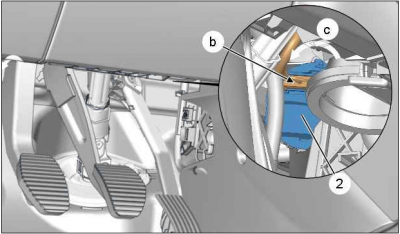

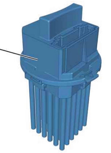

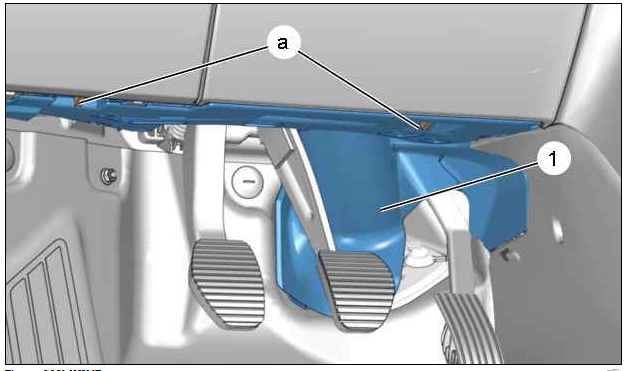

The system utilises a digital Blower Control Module, pictured below:
The digital air blower control module permits control of the air blower motor in relation to a reference value. The signal is an OCR (Opening Cyclic Ratio) type digital signal. The value of the cyclic ratio of the control signal makes it possible to define the power requested by the vehicle’s passengers.
I would get it checked with Lexia first, to see if there are any other fault codes being returned before replacing the unit - but this is one of the likely culprits.
If this has failed, then the backup mode kicks in where the Auto function remains, but any pressing of the blower speed does nothing.
| Digital Blower Control Module. Part No: 6441S7, price £135.60 inc. VAT |
