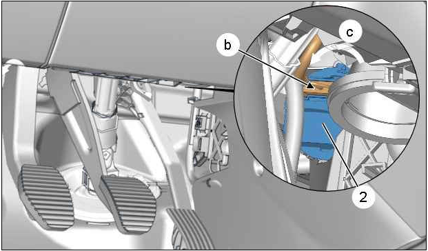

Re: C5 heater blower/fan stopped working
Note: C5 X7 only!
The system utilises a digital Blower Control Module, pictured below:
The digital air blower control module permits control of the air blower motor in relation to a reference value. The signal is an OCR (Opening Cyclic Ratio) type digital signal. The value of the cyclic ratio of the control signal makes it possible to define the power requested by the vehicle’s passengers.
I would get it checked with Lexia first, to see if there are any other fault codes being returned before replacing the unit - but this is one of the likely culprits.
If this has failed, then the backup mode kicks in where the Auto function remains, but any pressing of the blower speed does nothing.
| Digital Blower Control Module. Part No: 6441S7, price £135.60 inc. VAT |
- Posts: 9419
- x 1941
That's the type fitted to my X7. I have a long and personal relationship with it and can now take it out of the car in under two minutes.
It first went wrong (lost all blow) about a year ago and I took it out and gave it a good looking at to see if anything was obvious. I was that close to buying another one when I thought I'd just plug it back into the loom (I hadn't even screwed it back into the heater casing) and the bugger worked. I had sprayed the contacts with, err, contact cleaner so maybe it was that.
It ran fine for half a year or so and then the puff stopped again. I took the unit out and gave it another close inspection and sprayed some more contact cleaner but this time there was no improvement. I had a look around for a replacement and located one at a breakers about 40 miles away. I rang them up and they said that they would take it out for me. Great, I said, I'll be down later this afternoon. That was when they said it would have to wait its turn as there were other customers in front of me. I said that it only took a couple of minutes but that didn't make any difference. As I was due to leave for France the following morning I had to put the old control unit back and, guess what, it worked of course. And has continued to work since then which was last April (I last drove my car three weeks ago as we're on holiday so I hope it'll work when we get back).
So try plugging and unplugging it from the loom a few times; you may find it'll come back to life. After all mine has - twice.

Yes, my experience has made me wonder how many of these, and similar items, have been replaced when all they needed was reseating.white exec wrote: 12 Aug 2018, 21:47 Aren't PSA electrical connectors and module joints just wonderful? Quite a long tradition now...![]()
