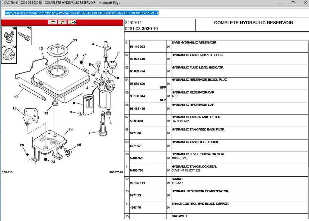

Hi Lazza
Once I had the same problem of a stiff steering and car didn't raise, it was after I replaced the hydraulic tank block part #2. After a while I noticed that when the hydraulic cap ( part #5 ) is pressed with a finger all is OK. So I replaced the O-ring part #12 and it sorted the problem.

The hydraulic cap ( part #5 ) and O-ring part #12 can be detached without removing the block itself.

HI Good news!
After taking the whole hydraulic tank out and having a proper look at the filters- just as CitroJim "the oracle" said- black fur coats!
Cleaned them up, but it all back together, and wahey!! It's like driving a new car... so smoooooooth.
Thanks guys, as ever!
