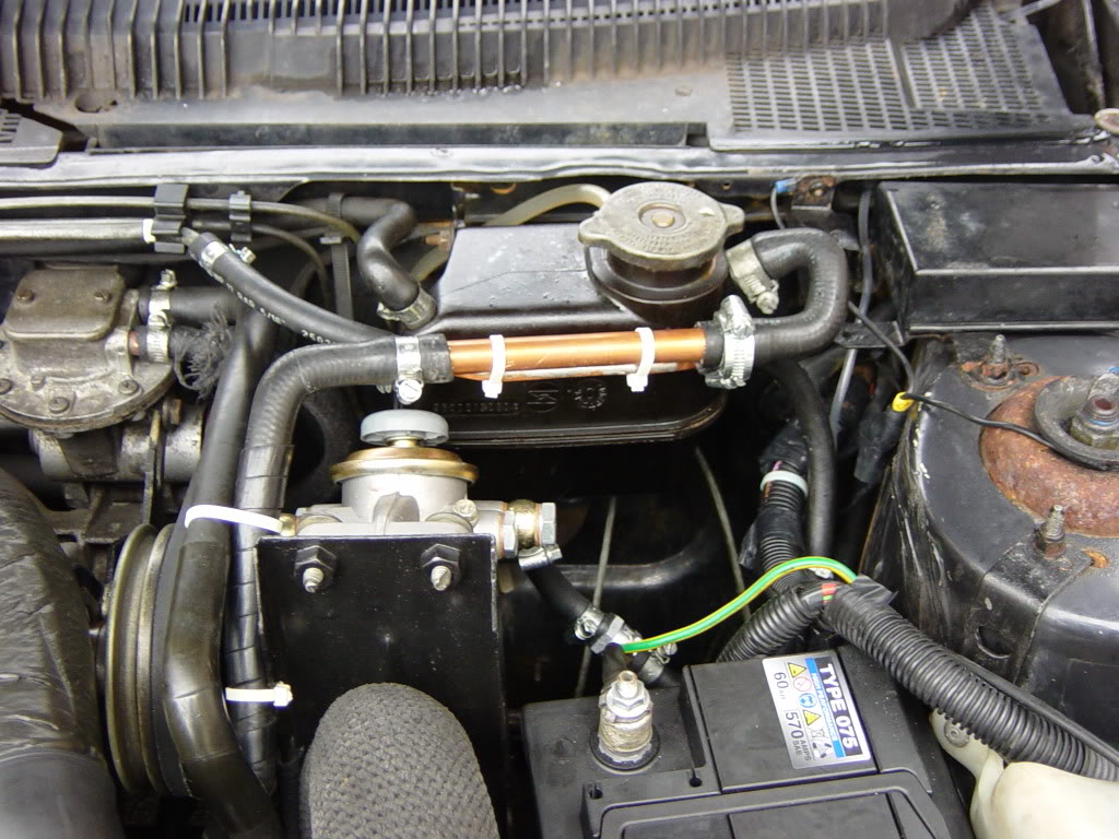

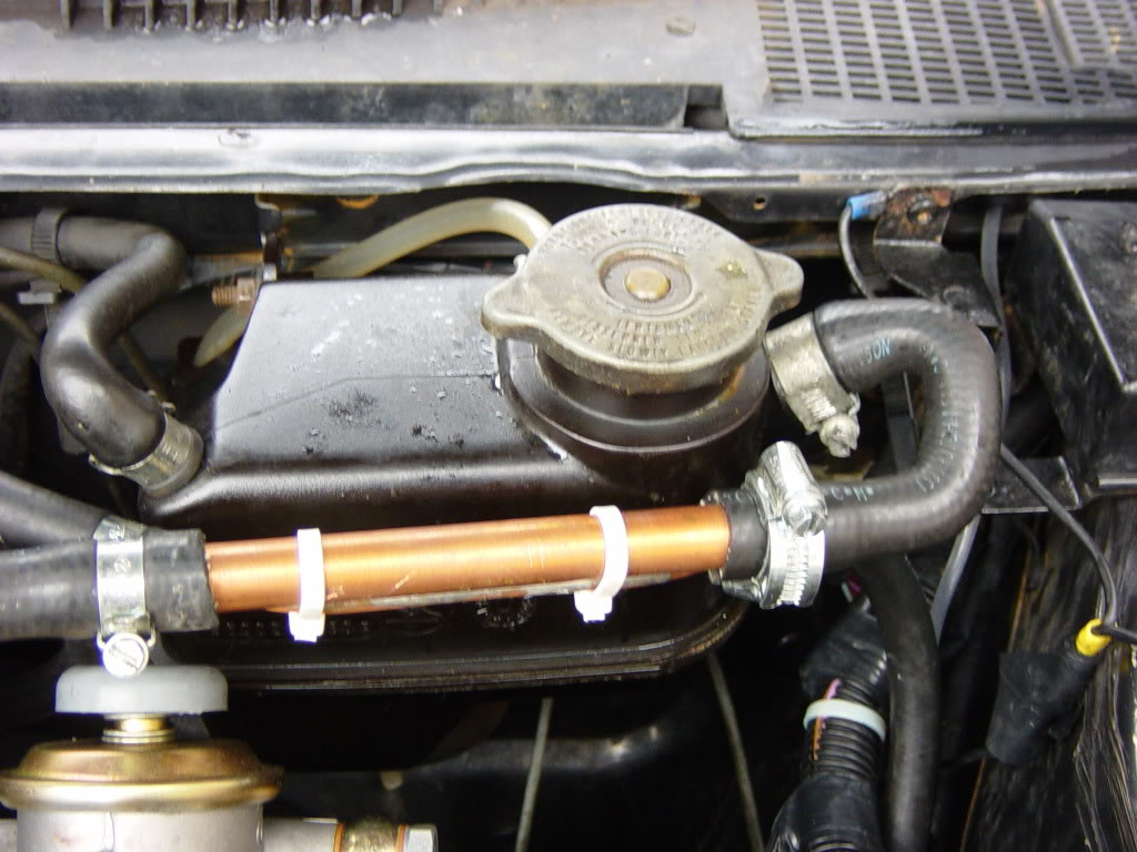

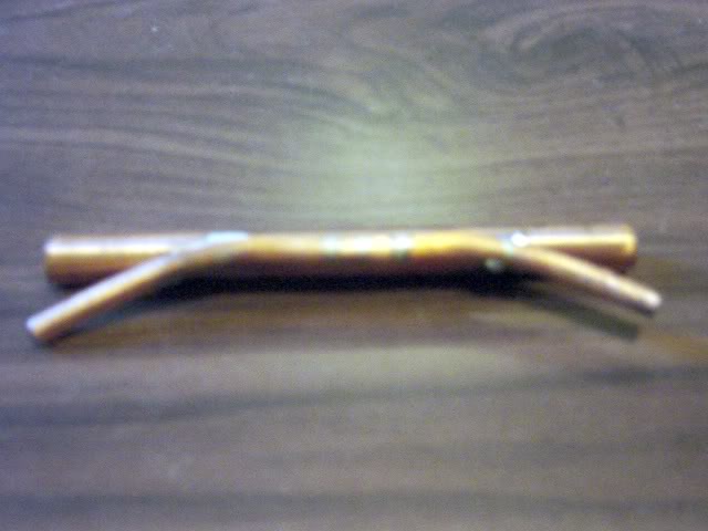

Regarding fuel heating, well the 205 had the nasty 'back of block' heater that loved to take in air, so I made a heater using some standard 15/16mm plumbing pipe and a piece of microbore pipe. I gently squashed them one at a time in a vice to give one 'side' a flattish edge. I then cleaned them up with rough emery and clamped them side by side. At this stage I was able to place a line of plumbers solder in the middle of them and take them to the gas stove (not recommended but I did not have a blowlamp to hand!)
The 'microbore' pipe had the fuel supply from the bulkhead pipe to the filter head. The larger plumbing pipe had the coolant return feed to the bottle as this permanently circulates plus it was easier than trying to cut into the heater hose too.
Pics...
The cable ties are *not* holding it together they are just there for the sake of it
I painted it in black smooth-rite (minus the ends) a bit after taking those pics. I ran that for a long time without issue. "Your miles may vary" as they say but I found it does not heat the fuel "enough" to be anywhere near the ignition / flashing point for diesel...
The factory top hat type 'thermovalve' from memory actually only heats fuel up to about 15c from what I recall anyway.
Pics...

Your heater solution is very elegant Andy... I like it...
It would be even more effective if the small copper pipe was tightly coiled around the cooper coolant pipe...
No special tools needed. Just make sure the small pipe is well annealed

I did try that JimCitroJim wrote:Your heater solution is very elegant Andy... I like it...
If I do it again, at least I'm well armed now to deal with it.
I do not have a pic of it in black smooth-rite unfortunately, although it blended in quite well. Reminds me of the metal lower coolant pipe (Between the bottom radiator hoses) I obtained a new one as a matter of course when I was changing the water pump and that (apart from the ribbed ends) had a healthy does of rust proofing too. Timed that quite well actually as the old one was upon removal and inspection not far off crumbing.

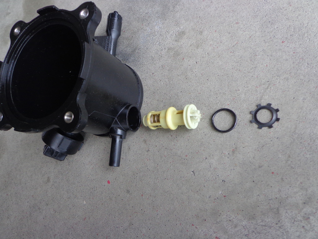

I removed the filter housing to get a better look at the thermostat, O ring is VERY brittle and split. I will get a new O ring and make sure the thermo is clocked properly to get correct flow, refit and hopefully problem solved. PS there was a lot of crud in the bottom of the housing so its now spotless.

Make sure any replacement O ring is diesel-proof by soaking likely candidates in a jar of diesel for a while... Some may well not be... Same applies to their LHM suitability...
Try to get an O ring made of Viton if at all possible..

Yes I nearly lost the star clip when I went flying across my bench. There is another small O ring I just discovered stuck inside the thermo hole.

Is that other O Ring on the other end of the white part?

I'm 99% sure if you just screw in a plastic bolt or something (might have to carefully tap the housing, not too deep!) you will have permanent fuel heating.
Last time I looked that part itself the thermovalve is not available separately. Its the complete housing unit.
Regarding the 'water in fuel' as Jim has said it was deleted from later models, they either have a bung in there or the housing is not tapped for it. Interestingly the wiring multiplug is still in the loom on some models but I guess that's half expected.

Yes correct, it got left behind when I pulled the thermo out.CitroJim wrote:Ping!!!!! I know exactly what you mean...
