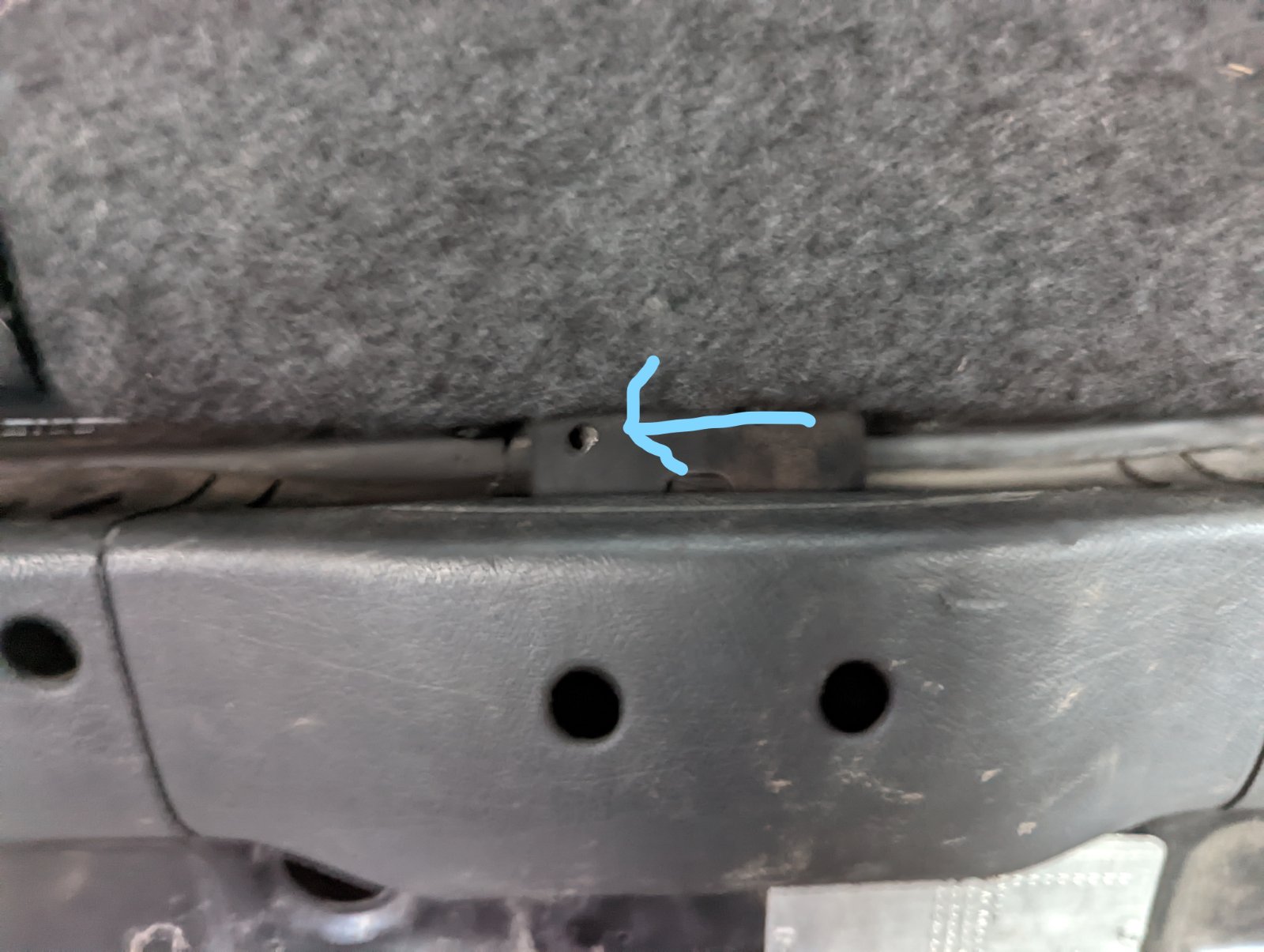

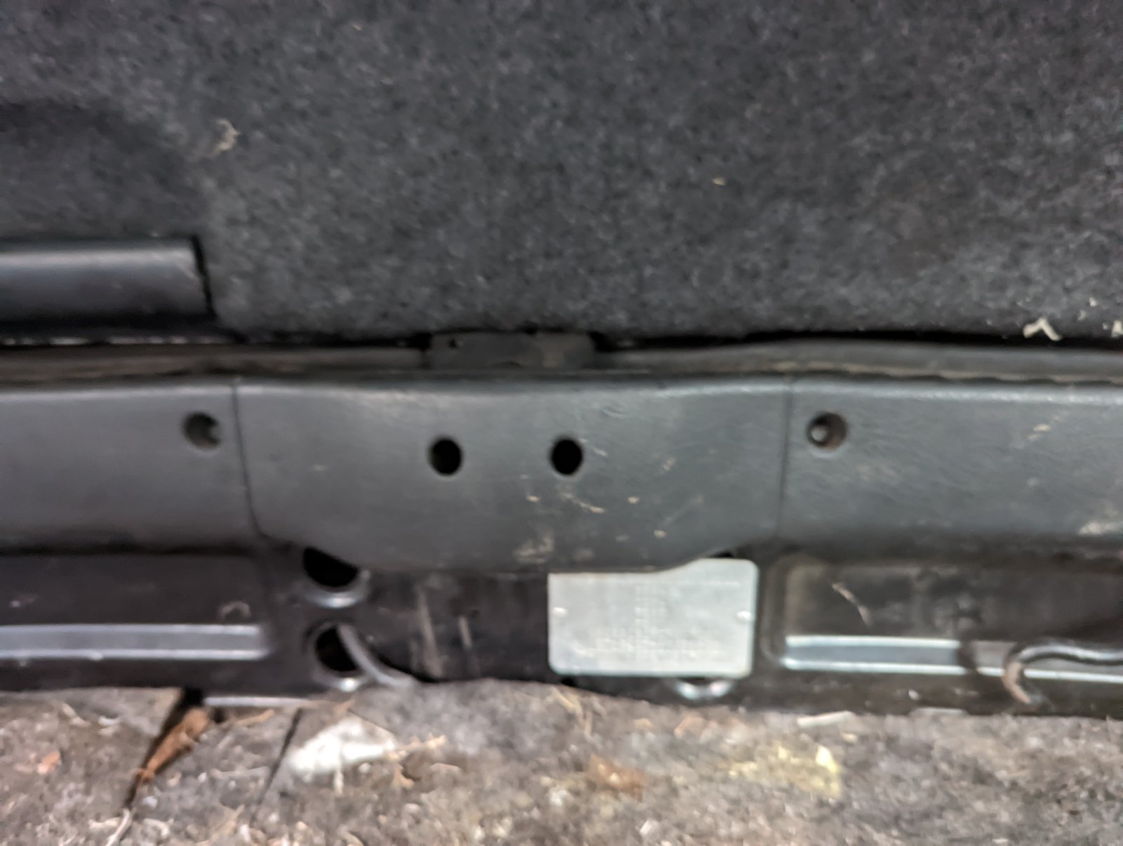

Xsara hatchback manual boot release. Obvious when you know. NOTE: This is not a Picasso. It's a hatchback Xsara.
Short story long. The exterior tailgate switch stopped working years ago, not a problem as the keyfob worked it. Now the keyfob system has died so had to look for the manual release. I'll wire a relay near the BSI to swich 12V to the unlock solenoid from the tailgate 0v switch input.
Good wiring diagram for me further up this thread.
Anyway: Boot release Xsara Hatch: Use a small scredriver and just flick the catch in the hole to the left/
Long story short: It took me days to find where exactly the manual release was.
