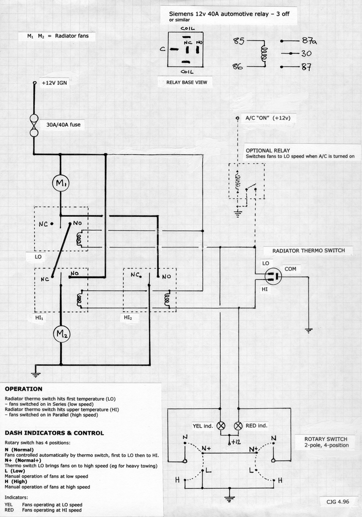

I didn't realise you were going to go down the (older) thermoswitch route, but no matter, if it works and brings on the fans first at slow speed, and then at fast, that's good enough.
Herebelow a circuit which shows just that sort of set-up. I did this myself on a BX19RD, when converting from one fan to two:
The circuit uses exactly the same triple-relay set-up found on our cars, but is fed by thermoswitch (and not ECU, where the arrangement is exactly the same). It's also essentially the same as the Italian circuit you posted above.
It's also possible to have the AC automatically switch the fans on to Lo speed. The circuit above shows this, too, as an option.
There is also the option of a dash-mounted manual control switch, and indicators, at the bottom of the circuit. This can be omitted.
