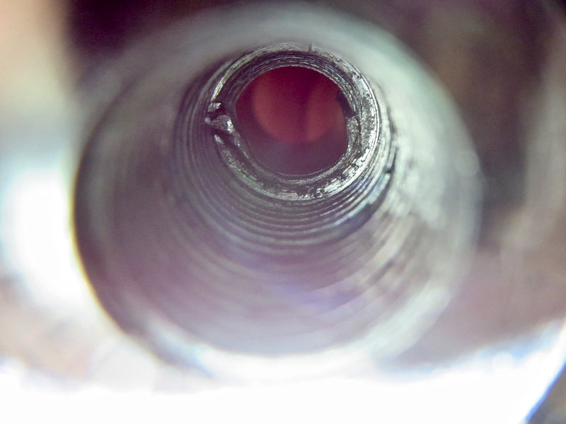

OK the replacement hydraulic adapter arrived today. I just looked inside where the cunifer flare sits - and it doesn't look good to me. I've taken the best photo I can and included it here. There were no seals with the kit - should there be some? I can't see the flare sealing inside this fitting - no wonder the original one leaked
UPDATE: Well I fitted it - and I really don't want to tempt fate - but this one has sealed! I've tied some tissue around the fitting to detect any leaks and will take it for a drive later.
