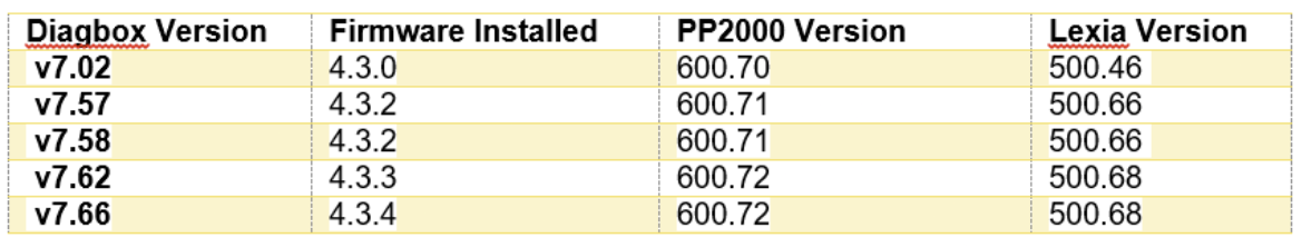

x 6955
Re: Diagbox installation problem
Not really - the VCI firmware is updated automatically in line with the software version when you apply each update:
If you have already upgraded to a version as shown in the table, then the VCI will already have the corresponding version of firmware applied. The correct version is needed to work with the software version used. To downgrade, you would need to manually reflash the firmware, but there is no point really - not for a 2015 vehicle.
