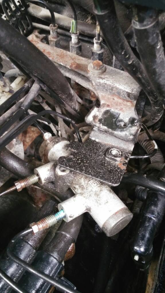

Made a start on trying to access the safety valve. LHM reservoir out, depressurised as best i could considering that i mistakingly thought that there'd be little or no pressure left due to the leaking pipe. So i released a pipe on the antisink valve only to be covered in a shower of frothy lhm!!
The safety valve or what i believe to be it is located UNDERNEATH the antisink valve and looks decidedly manky all round. That is the little i can see of it. Looks a nightmare to access! It's in there somewhere ... here's a pic, you might just be able to see it underneath the antisink valve peaking out.
Any ideas at all? I'm thinking of removing antisink valve, abs block (the unions undo but the pipes dont want to separate) to see if i can then get at that safety valve.

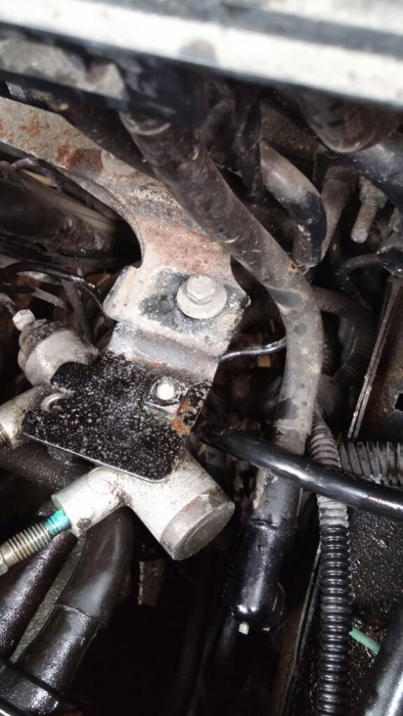

Getting nowhere fast with Scraptiva2's bust pipe [emoji20] . Access is nigh on impossible, not helped by the fact that most bolts are upside down so getting at them from the top is [emoji35] . I've only managed to release three of the five antisink pipes after removing the abs block mounting plate. The mounting plate for the antisink itself is a major blocker. Has anyone ever removed it?
Image Just cant get a flare spanner on the other two. I need a n offset flare set i think. If i do manage to get the antisink out of the way the access to the safety valve isnt looking good either. All in all [emoji20] [emoji20] [emoji20]

Something that might help is a ring spanner (with an offset) of the right size with a slot ground through it. A 6 point ring would be better than a 12 point, as it would provide a better grip onto the nut head union.

An 8mm flare spanner is a handy thing to have. I must admit, most unions I try and undo never come undone. I tend to cut the pipe with a pair of side cutters then put an 8mm six sided socket over them, they always unscrew then. Problem is you end up with a lot of pipes to replace.
That valve is in an absolute swine of a place to access, Mike.
I've done it on an HDi, I took the intercooler pies off, LHM reservoir out, and cut a spanner in half and managed to get that pipe out. I believe access is made a whole lot more difficult given that there's a TCT under there.

Faced with access into that area for some repiping work, KennyW removed the subframe.....

I do already have a full set of flare spanners, problem is that you cant swing them in the space. So ... i've just ordered up a set of flexi ratcheting flare spanners. Let's see how they perform [emoji6] Being ratcheting i just need to be able to lock on to the pipe and should get the last couple off. Rest day tomorrow then ....

Spanners and 4.5mm piping duly arrived and after a couple of hours pondering and scratching head i've decided this old girl is off to meet her maker. That safety valve is inaccessible to me .... what a stupid place to fit it, car's on low suspension and i've little else i can do for her. Let's hope nobody else has this problem [emoji20] I'll strip out the leather and carpets though before she rolls away and fit them to Scraptiva1 which was the plan all along. Anything else useful (?) will be stored as best i can. I've had enough!! Got a 2 week cruise around the Med coming up followed by daughter no 2's wedding early September. By then it'll be dark all the way to winter up here and not car fettling weather so guess i'll get rid on my return.
