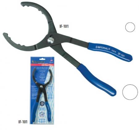

If it is a replaceable paper filter then the retaining ring can be quite difficult to shift.
I bought some oil filter pliers and they do the job quite well and are not expensive.
If it is the second type, I always remove the filter housing and give it a good clean. Probably unnecessary but doesn't hurt.
