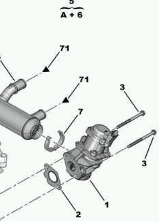

OK, PSA part number 1618 NR. or 9672880080
Here's a link:
http://www.ebay.co.uk/itm/Peugeot-Citro ... 0891194416
frogdr1ver
- Posts: 18
- Joined: 27 May 2016, 16:57
- x 6955
Re: C4 Grand Picasso - Flat Spot / Intermittent Gear Change Problem
Well Euan, it seems that both are valid parts depending on the sites you use - you have the 110 DV6TED4 FAP engine.
Could be the branding and whether they come with the gasket and seal or not. If you put the 1618NR in without a space in the search engines, you'll get both these parts coming up - so I would go with the one that is already in your vehicle.
http://www.carparts-pros.com/page_1_3.php#oeformo
https://bartebben.com/online-parts-sear ... NotFound=1
frogdr1ver
- Posts: 18
Morning, thanks very much for all the help again. looking on ebay i assume this one will be correct http://www.ebay.co.uk/itm/GENUINE-VALEO ... SwT5tWPLRL ? the part numbers seem to line up in the description, spoke to the seller and he says they are genuine Valeo. I assume these dont normally need setting up but are plug and play?
- x 6955
They don't need coding Euan, but it is important the seals are replaced according to the docs - here's a link to the installation / removal PDF for you that I printed off that mentions the seals etc. :
Picasso EGR Removal & Fitting
(note - make sure you select the 'Download through Browser' button)
frogdr1ver
- Posts: 18
Much appreciated mate, bit paranoid after the problems with the last one so want to get the right one and get it working this time. Will order a new gasket as well and the clip i have is a screw together one as well. Fingers crossed its more successful this time.

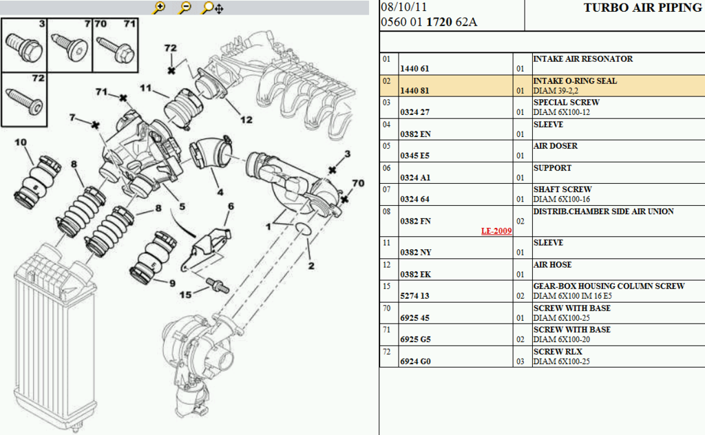

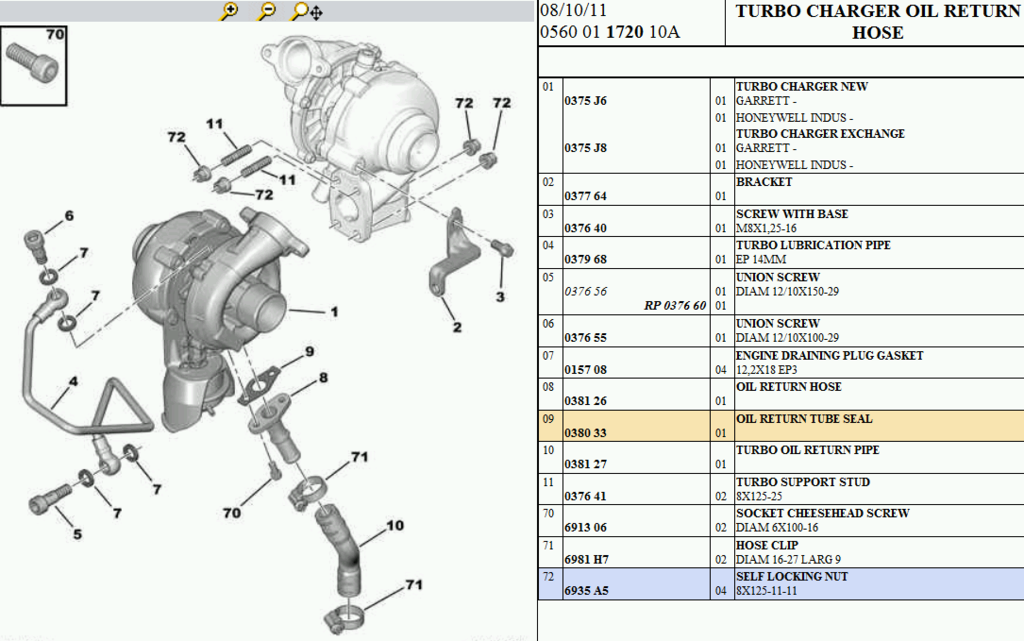

I hope so, didnt replace the DPF just told it that it had a new one, wonder if the ECU has a protection mode as well expecting a blockage? Last thing id like to do is sort the minor leak on the turbo inlet here
any idea of the seal part number or if you can use any type of sealant?
Many thanks for your help with the part numbers through this. Would be nice to get some confidence back in the car again!
any idea of the seal part number or if you can use any type of sealant?Many thanks for your help with the part numbers through this. Would be nice to get some confidence back in the car again!
- x 6955
Re: Particle filter at risk of blocking and p0238 fault code.
If it's the oil Return hose - the gasket is part number 9 Euan (0380 33). I wouldn't use sealant - just replace the gasket

- x 6955
Of course - different diagram / orientation! Number 2 in that case.
