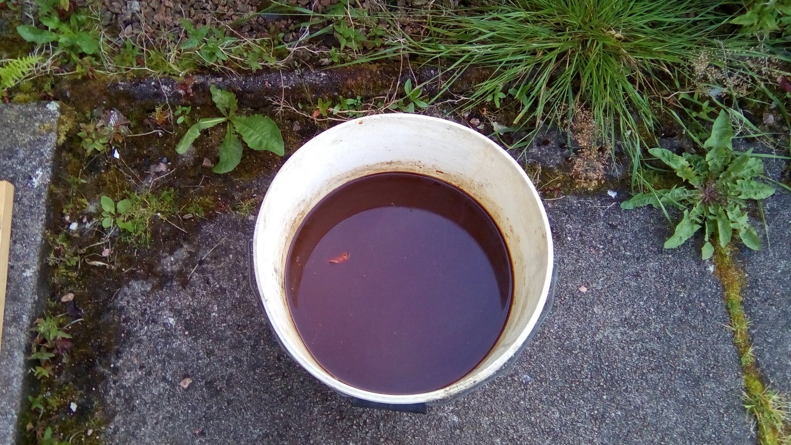

My 25mm core plug arrived today!
I managed to drain the coolant...
Grim!

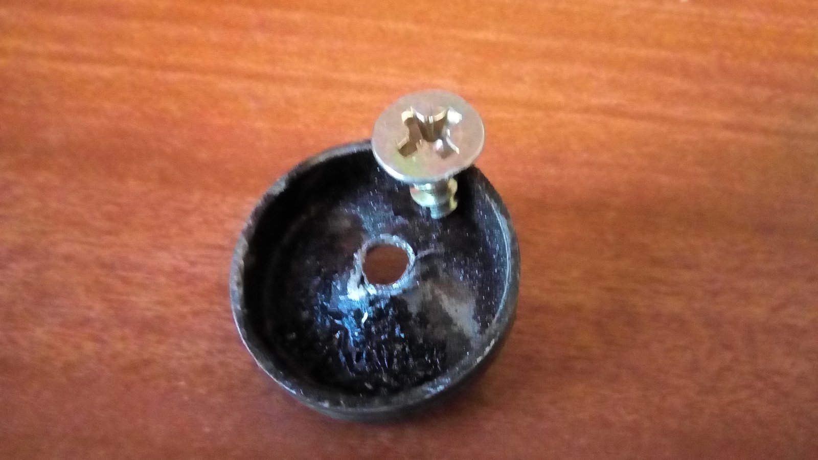

Then I also managed to remove the core plug... 2 holes because the first pilot hole I drilled was 4mm, too loose for the screw. The 2.5mm hole worked a treat!
I then found out that a 25mm core plug is not what I need. I need a 30mm. It seems a fairly common size, so I'll check the local motor factors tomorrow. Luckily I don't use the car to commute, I just cycle a mile to work!

Definitely due up for a change!

Here's hoping one of the local motor factors has a 30mm core plug, and I can book the work van...
Supernaut
- Posts: 23
- Joined: 16 May 2016, 22:34
- x 4
Re: My Xantia HDi Shed
UPDATE:
30mm core plug is too loose. I also got a 32mm, which is too big.
It seems I need a 31mm core plug, which doesn't appear to exist anywhere to buy. Can anybody look up a part number for this?
Or, is the other option that I'm just not hitting the 32mm core plug hard enough, and the one I took out only looks like 31mm on my measuring tape due to being distorted when pulled out? The 32mm really doesn't want to go in, whereas the one I removed will sit snugly.

I thought the whole thing about core plugs was that they ARE slightly undersized, but convex - so when you tapped them in they spread, thus holding them in place & sealing them round their circumference.

Pretty sure I looked before, and the plug is not listed separately. You might be able to find an imperial one that is a fit? 1" 7/32 is pretty close to 31mm... Or get one made to order. Or weld up the one you've got. Or find one from a stat housing from a scrappers. Or get the stat housing milled out to take a 32mm plug..... none of them particularly straight forward!

Take the 32 mm one and give it a file round the edges, then sand paper it. Make sure the opening is clean and worked with sandpaper too. This might get you the fit you need. I replaced plenty on Land Rovers and they were always a tight fit. Need to start them off true and then use a block of wood and hammer to force them in level, till they are home.
