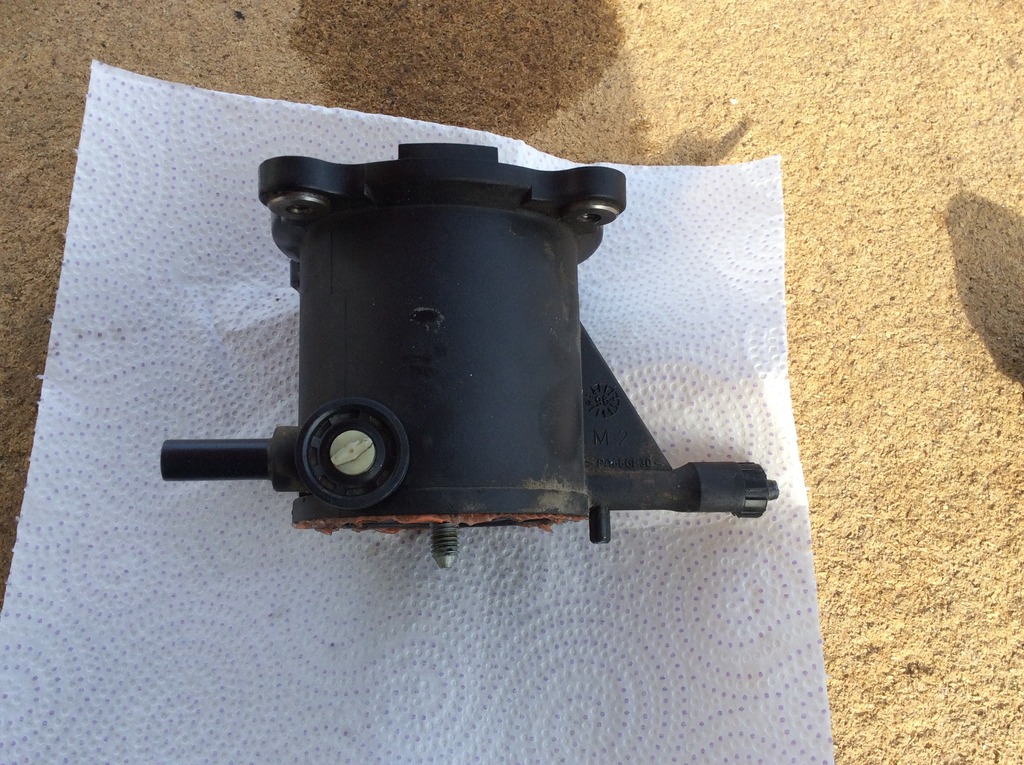

Jim, can I double check about this filter housing leak please? Do you know how it works?
What are the little arrows for? Turning it doesn't seem to change anything.
Thanks.
Thanks.

Re: Xantia fuel pump leak
Those arrows are, I believe , pretty much meaningless Jaf... The white bit does not rotate in normal operation.
Just fill the area around the white bit with epoxy resin and that should fix the leak. Just take great care to clean and degrease the area very thoroughly..

Right so sealed the fuel filter. That's worked beautifully.
Had another look at the banjo bolt, although the little holes looked clear I changed it with the one on the old pump. Car ran lovely for 30secs, smooth and quiet...then the air valve started leaking again and the car started spluttering and smoking.
Looking at the old pump the air valve shouldn't be anywhere near fuel. As far as I can work out air pressure from the inlet manifold pushes the diaphragm down, the spindle pushes into the pump for more fuel. Can anyone explain? Any ideas for a seal?
Jaf, yes, there should be no fuel in that area.. Too late tonight but let me have a think and a look at some documentation. I'll be in touch later...

Jaf,
Sorry for the delay but today I had to take my little girl back to University... Nice to take a long run out in the Activa.
Now, your pump. The only place that diesel can get into the area to cause a leak out of the air bleed is past the metering pin shown in the diagram below at Item 4.
Either the pin is excessively worn or the return fuel line back to the tank is blocked. I still suspect the latter. Disconnect the fuel return line at the pump end and blow down the line. You should be able to make bubbles in the tank. If you can't then the line is blocked. A good blow of compressed air normallyl shifts it...
Those two things above is all that it can be... Worn metering pins are vanishingly rare...
