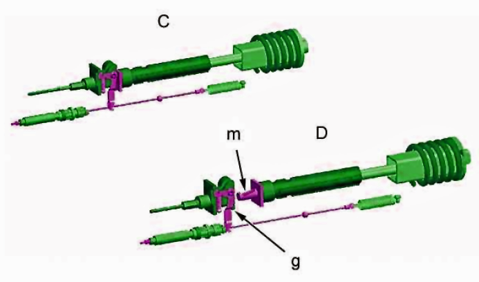

  • "C": Electric parking brake locked (Operational).
    "D": Electric parking brake unlocked.
    "g" Manual release mechanism.
    "m" Hook.
As you can see, once manual release has been triggered, the secondary cables need to be reconnected:
Back-up mechanical system for manual release
The splined shaft is solid with the release mechanism "g", linked with the rear right secondary cable by the hook "m". Pulling on the back-up mechanical control for manual release of the parking brake separates the hook "m" from the manual release mechanism "g", so releasing the forces transmitted to the brake calipers by the secondary cables.
Following release of the electric parking brake by means of the manual release mechanism, the rear brake secondary cables must be reconnected. The reconnection procedure is carried out by the electric parking brake ECU at the request of the user or of the ESP.
During the reconnection procedure, the electric parking brake ECU controls the motor in the maximum release direction to bring the splined shaft to its stop. The hook "m" hooks onto the manual release mechanism "g", the rear secondary cables are attached again.

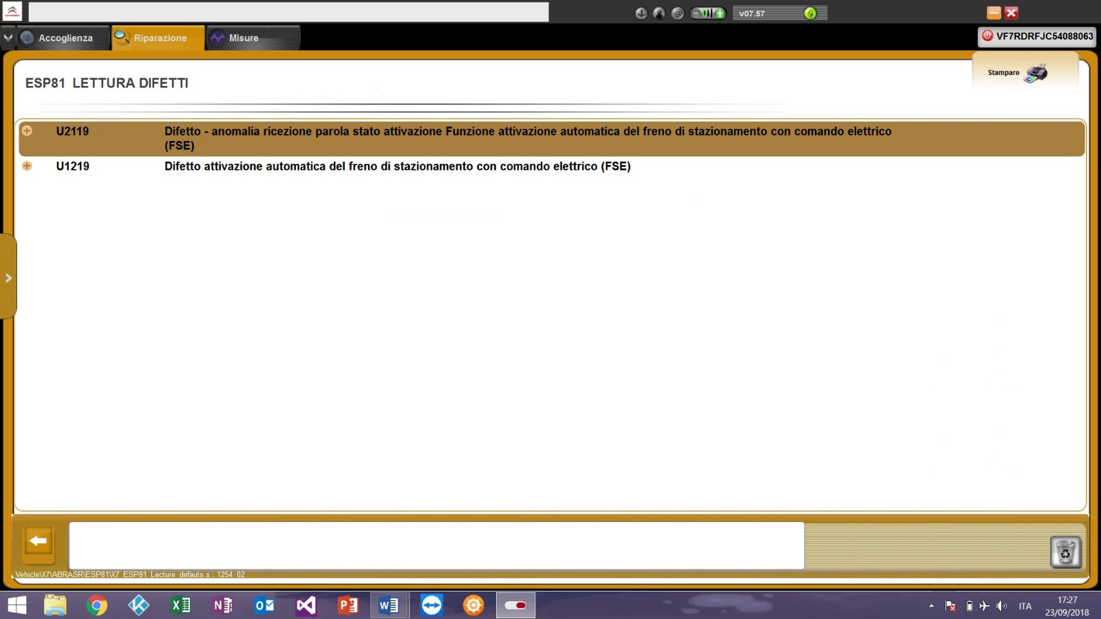

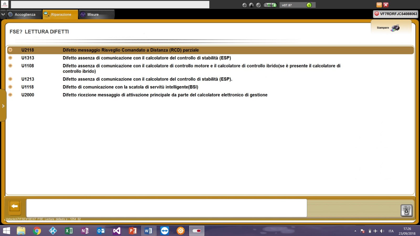

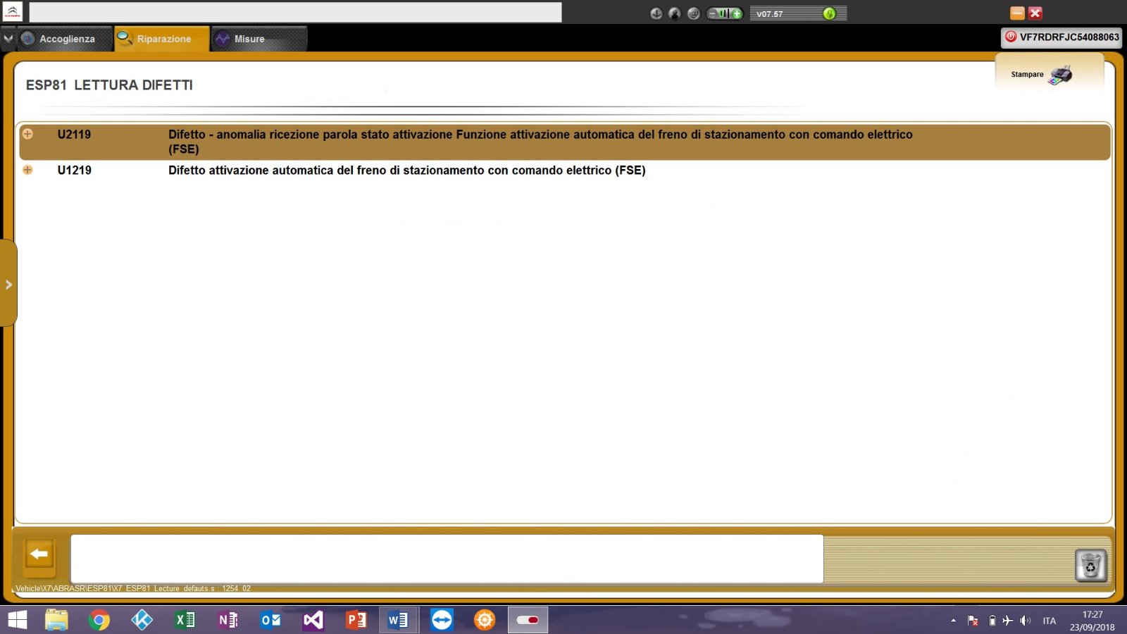

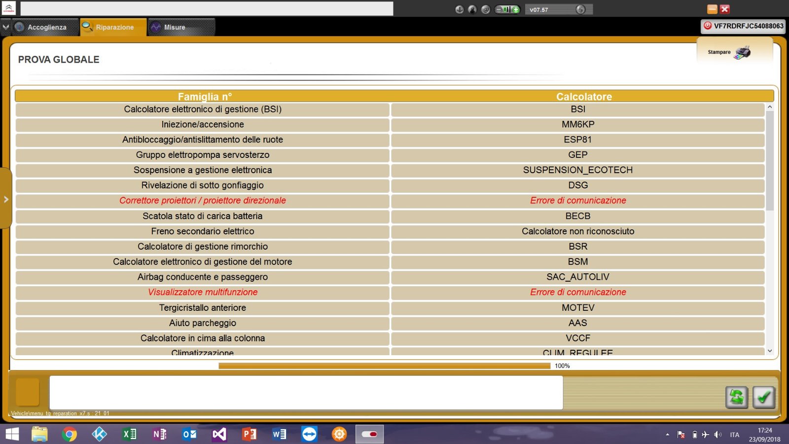

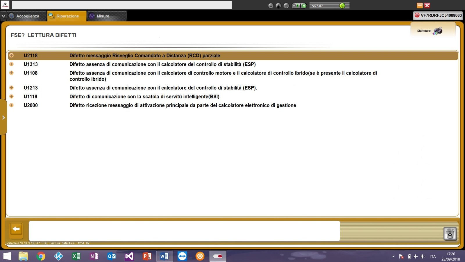

I've also made another global test with the DIAGBOX and it gave me some errors both in the EPB Section (in italian is calle FSE) and in the ESP Section.
I attached some screenshots of the DIAGBOX listing all the errors detected.
Global test results (FSE is the italian for EPB)
EPB errors list
ESP errors list
I hope it can help you to better understand the situation.
Thanks a lot
x 6955
Re: C5 (X7) Electronic Parking Brake problem
Ok leave it with me - the first screen shot is just saying there is no communication with the directional headlights or the multifunction screen ECUs. That should have nothing to do with the parking brake - however, I do need to ask if you have replaced/ changed / upgraded the car audio system / head unit?
I will study the other errors and report back shortly.

Ok, sorry it has taken me a while to get these together, I've been a little busy today. All these codes have a common reference - ESP ECU. As I mentioned earlier this plays an integral role in the operation of the EPB. As you can see from the diagnostic tables below, lack of Automatic functions including Hill Start are common when there is a fault. Some of the other faults can be caused by the communication errors. Have you changed any parameters anywhere for anything else (however small or insignificant you may think they are? Have you changed anything not related to the parking brake? A small change can affect the vehicle if the parameter is not relevant to this model - as the BSI is shared across PSA vehicles.
Looking at both the VIN numbers of your car and the donor car - none of these had directional lighting (Xenons), yet the diagnostic screen you have in the first picture indicated it is trying to communicate with the ECU - this should not happen. I suspect that the BSI has been configured incorrectly, because the BSI is looking for an ECU that it has been told is there, but is not. This tells me that the Head Unit and / or the multifunction screen has possibly been changed, since these have their own ECUs and they retain the parameters from the donor vehicles.

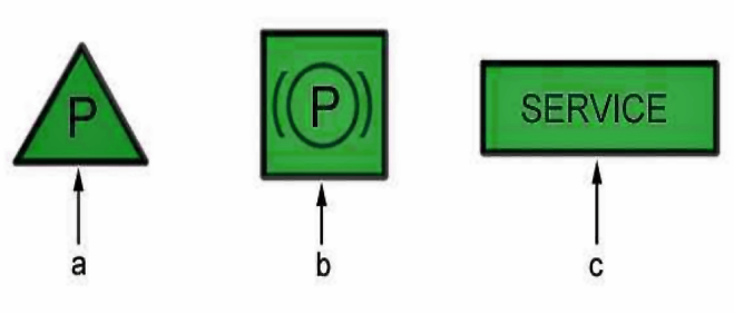

The lamps referred to above are:

lenny1972 wrote: 21 Sep 2018, 11:06 Great!
Very simple procedure. I'll give it a try as son as I can and I'll let you know
There’s one thing you can try. You can recalibrate the Parking Brake using Diagbox, as long as it can communicate with it.
Here is the procedure:
Connect Diagbox, either perform a ‘Test by ECU’ or a Global Test
When complete, locate the FSE or Electric Parking Brake from the list and activate
There should be a warning on the next page about ensuring the car is immobilised on a flat surface
Accept this and press the green tick to continue
On the next screen Choose REPAIR
On the next screen choose PACK REPAIR
On the next screen select REPLACEMENT PARTS
On the next screen select ELECTRIC PARKING BRAKE REPLACEMENT
On the next screen accept the information
On the next screen select ELECTRIC PARKING BRAKE CALIBRATION
Then follow the instructions, the tool will need to restart, just follow along and eventually it will say completed.
Let us know if this sorts it out.
