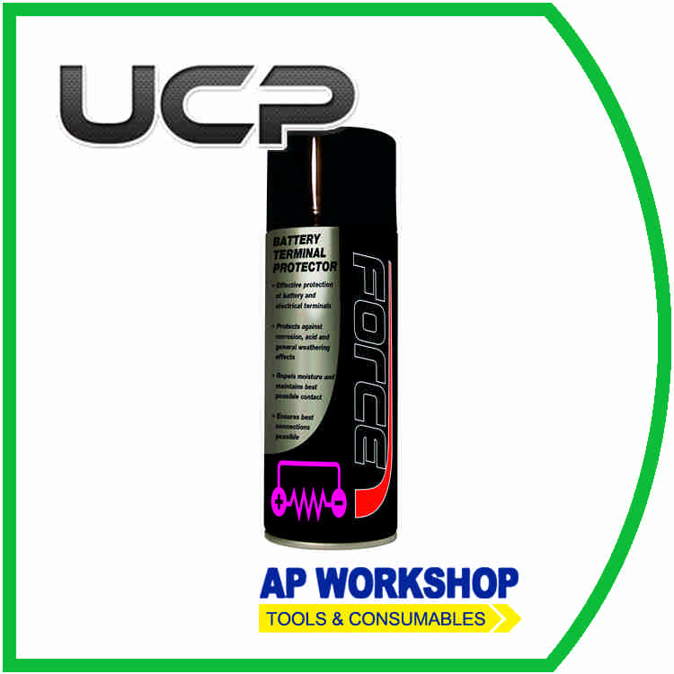

This is the stuff I use to protect alloy in areas such as sphere mountings etc, I also use it as intended in every electrical connection block/relays etc as well as the battery and the earth mounting plate.
I wire brush off all the paint I can and then apply this liberally. Water soaks into the oxide layer delivering more oxygen hence the corrosion, this seems to stop that.
Paint traps the water under it making the situation worse.
