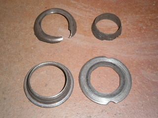

Monkeyfeet
- Posts: 353
- Joined: 08 Sep 2005, 14:37
- x 2
Re: No clutch, then no engine.
Gathered together what was left of the thrust bearing...
Apart from a few tiny shards in the bellhousing that was it.
