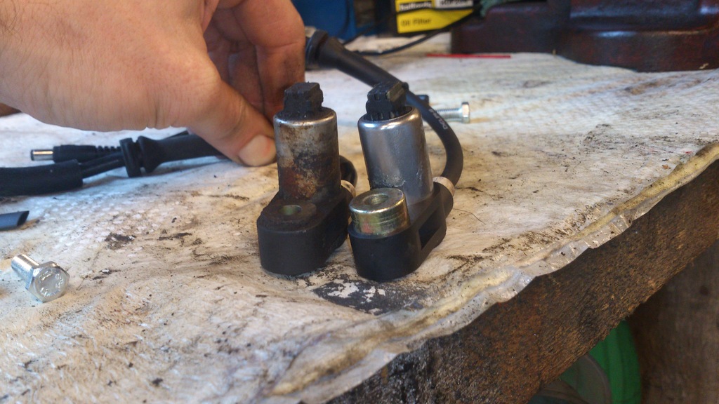

aerodynamica
- Posts: 1690
- Joined: 26 Dec 2007, 18:10
- x 215
Re: xantia mk1 ABS questions
Well, it seems I have fixed it - the sensor must be the second one you mention there, the difference I see comparing them (and might also be the difference with the bolt too?) is the depth of the boss for the mounting screw.
Here's the pics snapped earlier:
removed:
so you can see the difference.
I rechecked the resistances and they're all the same so I reckoned the 'wrong' sensor might work if I could reduce the boss extrusion so I removed it and set about it with a grinding disk. Quickly ground it down to match the old unit and now it seems to be working fine - drove 25 miles there with the light staying off, and a quick emergency braking test on a damp road (no other road users mind) and the ABS kicked in and no further sign of the abs light.
removed:

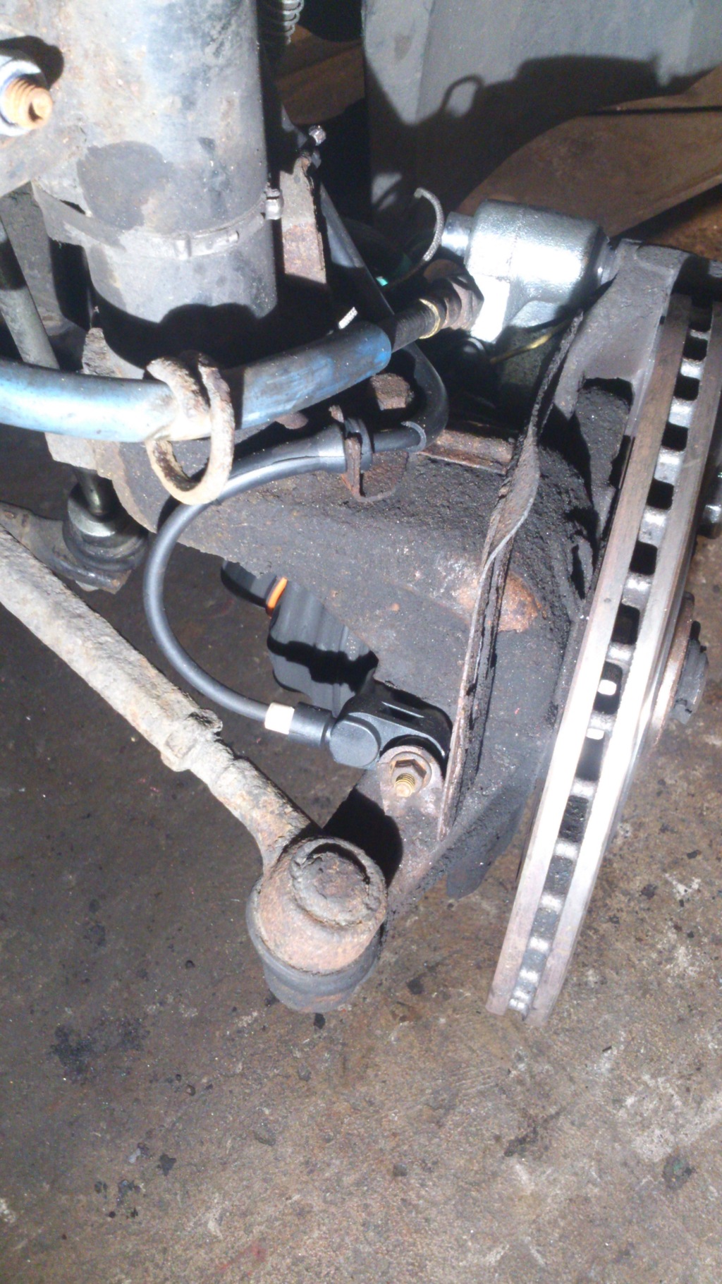

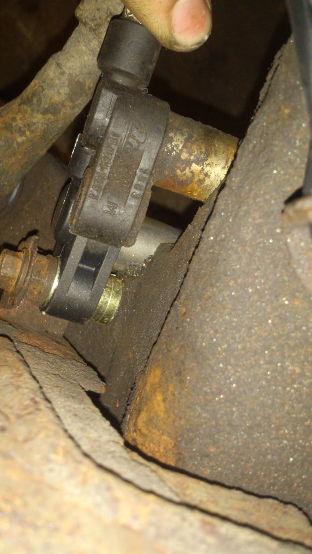

aerodynamica
- Posts: 1690
- x 215
Yes so the main difference between the early sinker and later mk1 might simply be the dimension of that boss. maybe the reluctor ring is a larger diameter on the later car and the sensor must be further out?
Here's how it sits now:
