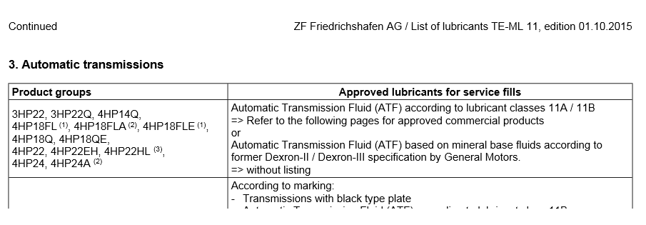

.....This confirms Jim's advice.
Direct from ZF the manufacturer of your gearbox.
The link takes you to a PDF list of approved lubricants for their products.
http://www.zf.com/global/media/en_zf/lu ... -ML_11.pdf
The full approved list appears on page 6 and 7.

thanks neil, I couldn't work anything out from the pics! but the other bit makes sense, my fluid is a lovely colour but I just don't think dexron 6 is right for it, that's what I think the gearbox place has put in, but I can't work out if they mean 6 as in capacity or 6 as in oil type, they will not answer my emails or get back to me about it, they were really awful to the last owners,
