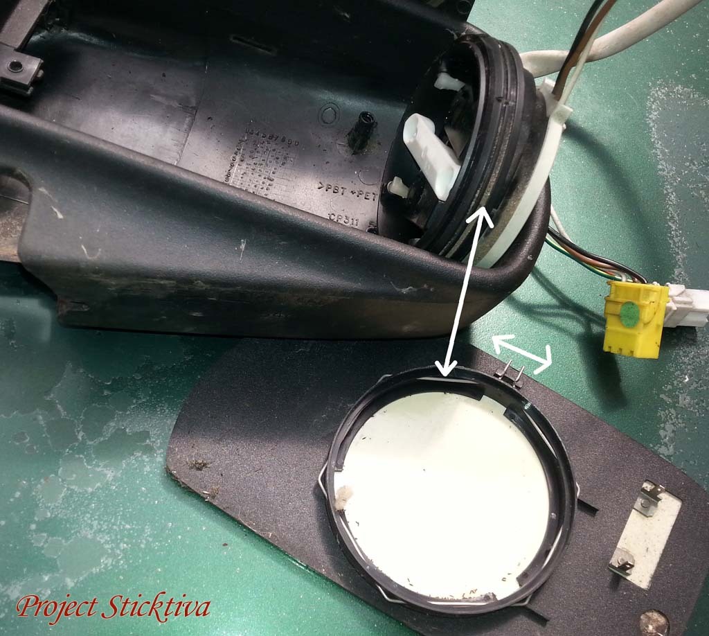

So, Mirrors done.
Needed to change one motor and mend one broken feed wire.....I did not need to remove the mirror unit from the car, bonus
If you have never seen inside, here it is (non-fold mirror, heated, S2 car)
Next job, spray the covers and the body mount silk black.
