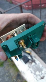

Thats vaguely what i was expecting! Can't find it anywhere on servicebox though!
There any part numbers on there? Im thinking its a junction box for stuff

Its definitely a relay with a bit of logic going on. I think it could be to do with the AC stuff now, because that never initiated the fans for some reason. Tomorrow PM I'm going to be going over the fuse boxes and checking continuity wherever I can. Sleepy now.

AHA!!!
Thats the Glowplug relay.
https://www.google.co.uk/search?q=glow+ ... 20&bih=920" onclick="window.open(this.href);return false;
i wondered why i couldnt find it anywhere on servicebox.
however, still doesn't point to your issues. hows the car today?
