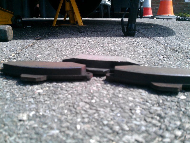

What I did get done was to change the brake pads, though I nearly didn't when I pulled the O/S caliper open to find they had at least half their friction material left!
Old set in front, new pad behind.
Only when I opened the N/S caliper did I find one pad near it's limit (the inboard pad was just as re-usable as the two above). What's weird, is the N/S caliper looks in best all-round condition and once started, I could wind the piston with my fingers all the way back in! The O/S was a mess though. The piston dust seal needs urgent attention so caliper service is now added to the job list. And the new pad springs I fitted, didn't seat as firmly on the O/S. The top fits tight, but the bottom is not and is, I suspect, the reason for the brake squeek I'm often hearing.
Anyway, just doing that has rewarded me with aches and pains I need to soak away in the bath. So if someone can tell me what nut size the brake pipes has, I'd be grateful. Oh, and when I've got that loose, how on earth does the retaining clip come off? Again, poor lighting, eyesight and access stopped me getting a good looksee but I couldn't see any obvious cut out, indicating where to place effective leverage? Cheers!

the usual cause for one pad out of a set wearing abnormally quicker than the others is, the caliper slides are seized or partially seized,
the nut at the caliper end of the flexi is usually 14mm, and the nut at the metal pipe adjoining the flexi is usually 11m,
the fixing for the body end of the flexi is either a curvered spring steel blade with a u shaped cut out the fits into a groove/slot in the flexi's feral, and above the mounting bracket/mounting,
i usually grab the edge of the blade with vice grips and move it side to side whilst pulling on it,
the other type of fitting is a spring steel arch with a hole for the flexi to come through, this type is held in place ( on top of the mounting bracket ) by the metal pipe flare nut,
as for brake squeek this can be caused by new pads being fitted were the disc has a lip/rusty band at the inner/outer edge/s, so the edges of the pad runs on these lips/rusty bands,
if i ever fit new pads to discs in this condition, i bevel both inner and outer edges of the pads off with an angle grinder
Regards, malcolm.
