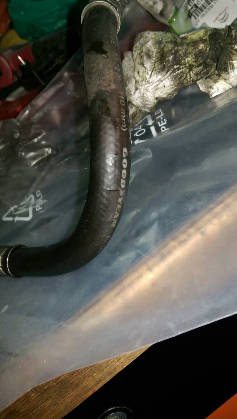

Had the pipe replaced today, you can see the cracks in the pipe where it was leaking from. The replacement part has been revised so hopefully there will be no repeat of the issue. Pipe, regas, pressure test and labour worked out at £150 so not too bad.

Final update (I hope) on my too warm C5, all sorted and nice cool air once again. 8-) and thanks again for the suggestions and positive help
Apparently it was the condenser after all, that pipe was ok. It took them just 3hrs to find the leak remove and replace the condenser and re-gas. Total cost a tad over £300 so I can live with that, in fact pretty good. A fraction of main dealer prices and a great service. (I had priced parts at more than that but they managed to get discount and after market parts - condenser a mere £160 - after market obviously but they may actually make them for Citroen [as I found was the case on previous suspension parts]).
