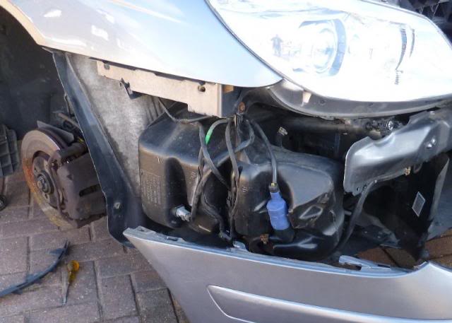

Re: 2002 C5 windscreen water bottle
Unread post by JohnD »
Don't think you'll change it from the wheel arch. Here's a picky I took last time I had my bumper off.
Image[/URL]
