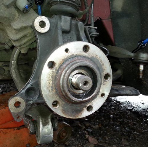

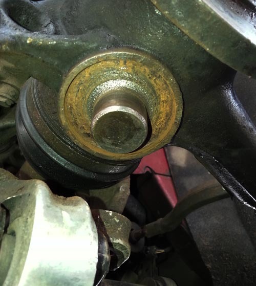

Did it on the car, caliper off, disk off (needed the puller as no copper slip behind it !..(gj again Hartwells) Lower thru bolt out, popped the steering arm ball joint (hammer) and (gently) pulled it forward.
The two large bearing bolts were rounded off so welded an old socket to them and used a long bar. Bearing dropped off (surprise surprise) and I dremmeled a slot and tapped the race off the spigot.
Then it rained and I had a cider....hic
Clean up the spigot in the morning and refit.....with new bolts, I am glad I said to the parts man....ahhh yeh OK then, its good practice so throw in a set of bolts ...thats carma man !

Maybe for grease a high temp waterproof type, like for trailer wheel bearings. Then a smear of Red rubber or silicon type grease over that rubber seal?
Just a few thoughts.
It's crying out for an old fashioned grease nipple. :-D Job wil be a good un Sticky.......very satisfying to replace to a much better standard than previous.

OK, all done and good.....
What happens behind a disk without protection....another basic missed by Hartwells "Technicians"...(don't MacDonalds' call their hamburger cookers Technicians ?)
Angle grinder with a brush got rid.....etch zinc primer and copper slip on hub surfaces and the disk should make it easy when I have to change the disks
I had to use a disk puller in the end, the caliper mount trick with two bolts did not work....borrowed my next door's Land Rover one ...BIG it was :)
Cleaning up, all was bright and clean in the end, used a small cup brush on the Air Drill.
Again.....thanks all for the help
