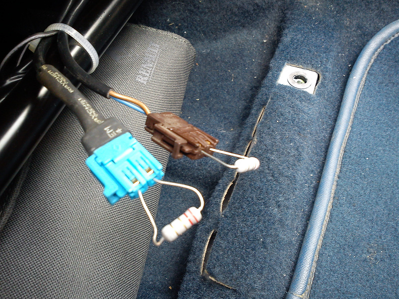

When I unplugged the connector in question on my car (driver's seat), immediately with the next key ignition (no engine) the error was up (air bag fault, something, can't remember the exact words) ...

Stickyfinger wrote:
2002 C5 2.0i AL4 240,000 km 76372389
- Posts: 11836
- Joined: 28 Mar 2013, 21:05
- x 1996
Re: Fault finding - 2008 C5 (X7)
these are 2.2 Ohm resistors, any good electrical supply store, allows you to test the wires while bypassing the Airbag.
I am not a qualified sparky, all I know is I used these to clear the airbag fault light and beeper until I got the plugs re-wired on my facelift Mk1
