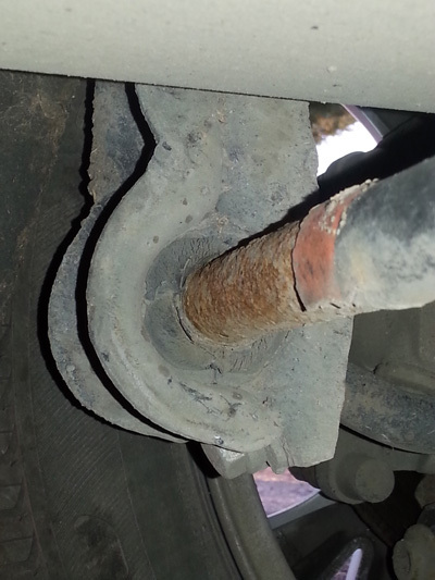

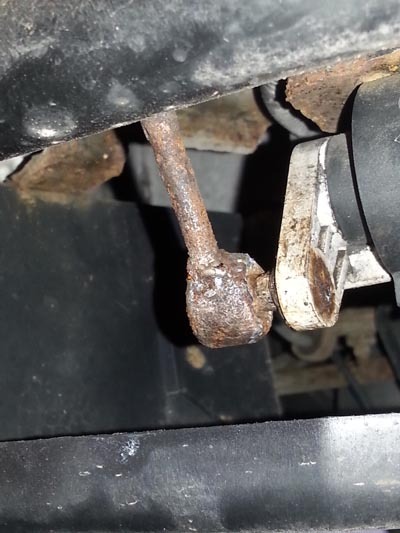

my present roll bar condition, you can see the mess under the cracked/brittle crap powder coating. Having had a closer look I think I may be able to clean them up, paint and coat the edges next to the bushes? what do you think ? urgent change or just clean ?........I will still arrange for a change I think to rid myself of the need later
And my temp repair to the dog bone...a tiny weld for me and my skills, esp as I had to avoid melting the inner plastic scocket.
the Fun part.....Citroen Main Dealers, HARTWELL in Abingdon, have been looking at this get worse every time the car was in to them over 4 years ......16 times in according to the paper work.....QUALITY Care of you £25k car..........NOT !
