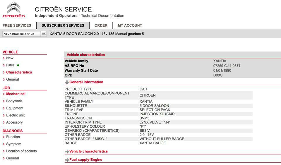

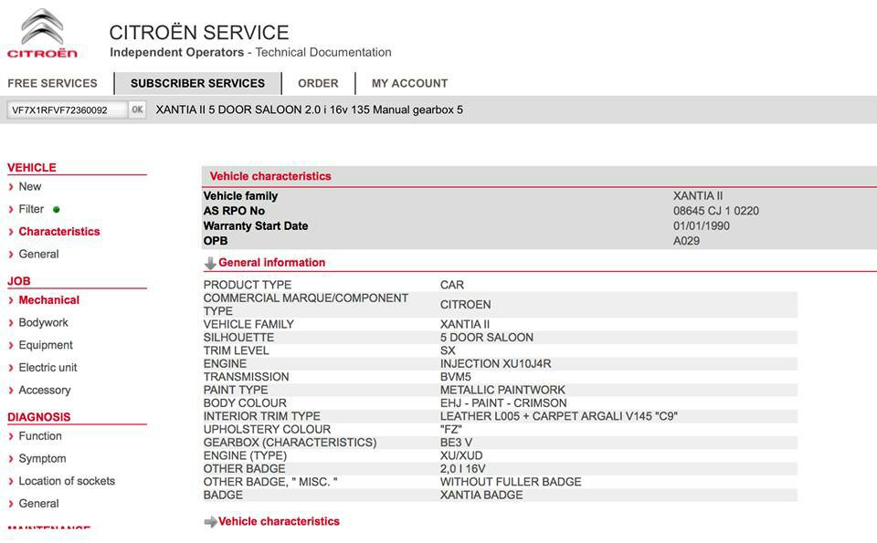

I found a complete ECU kit with key, transponder. The data of my car & the donor car matches except the ECU no. Mine is a Xantia 2 & the donor car shows as Xantia. Both YOM is also 2000 and the engine gearbox codes are also same. In the attached data sheets the 1st one is min & 2nd is the donor car. The supplier says that this will fit. The ECU connection clip also same. What do you think guys will this fit.

Re: Xantia Body Computer Programming
Going by the RP number the second car is a 1996 model so it wont even have a CPH

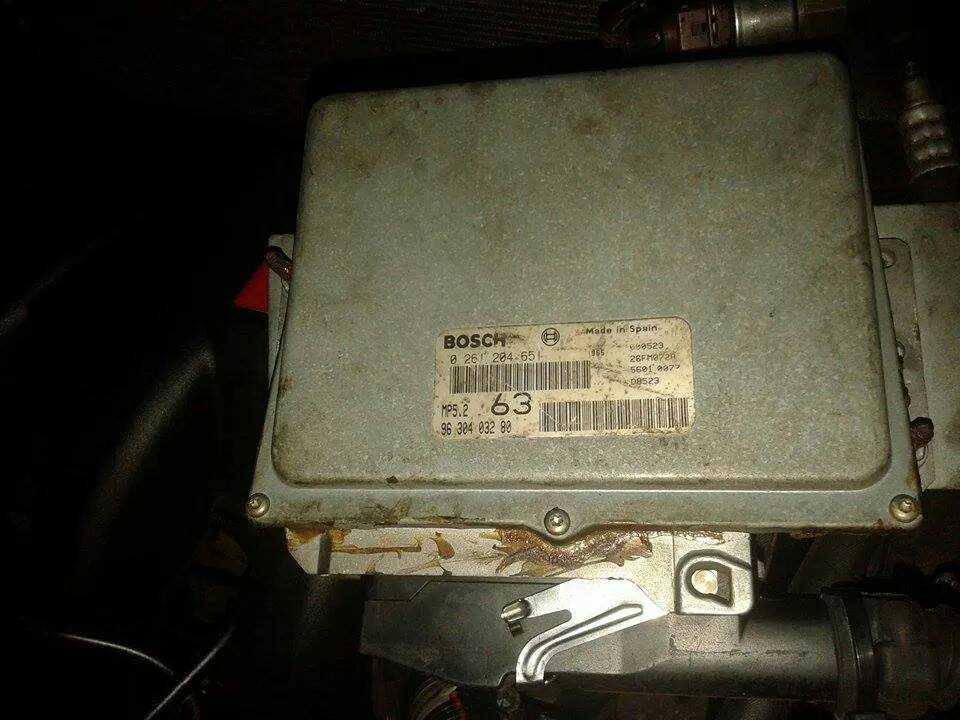

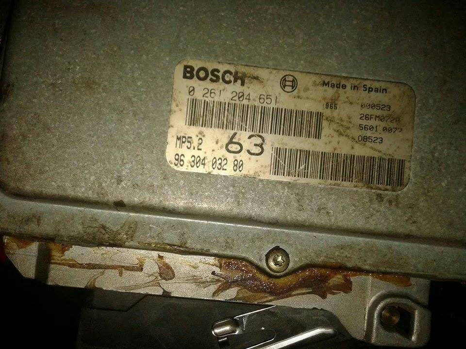

Can someone help me find a set. A picture of my ECU is attached.
