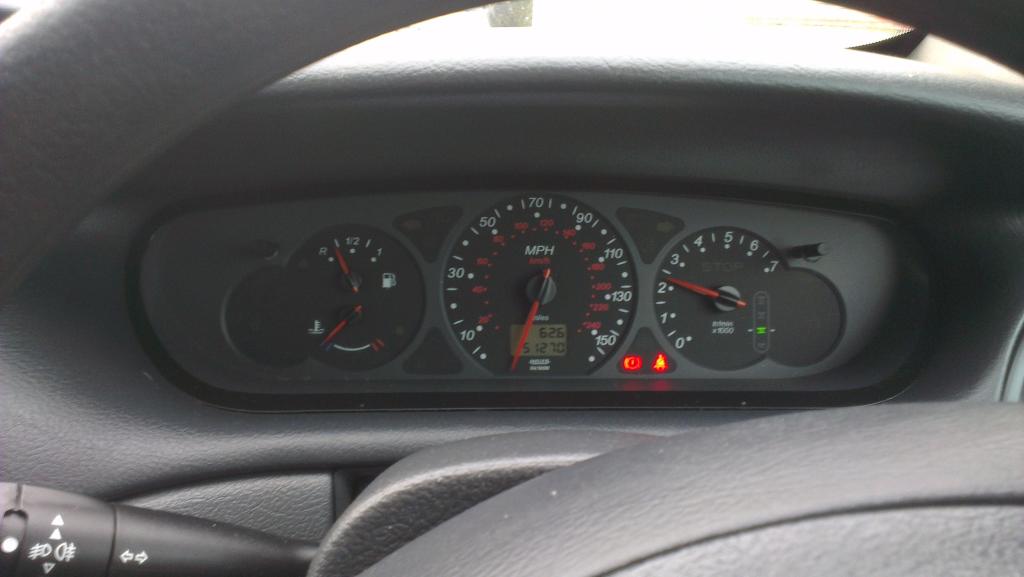

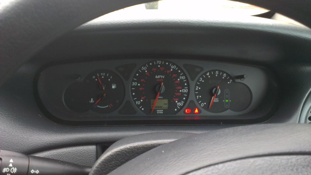

So, the clocks that I mentioned... This with the engine running;
This is with it properly revved up
And that's it - the tacho and speedo both under-read (you can see the speedo is way too low at stationary and it just stays that way).
Question is... What to do about it?

Re: Newly purchased C5
Believe if you remove the clocks you can just pull the needles off and re-set them at the correct position.
That sounds like a winner!
Anyone know why it happens in the first place?
Well the Speedo completely packed up at the weekend, so moving the needles is a no-no now!
