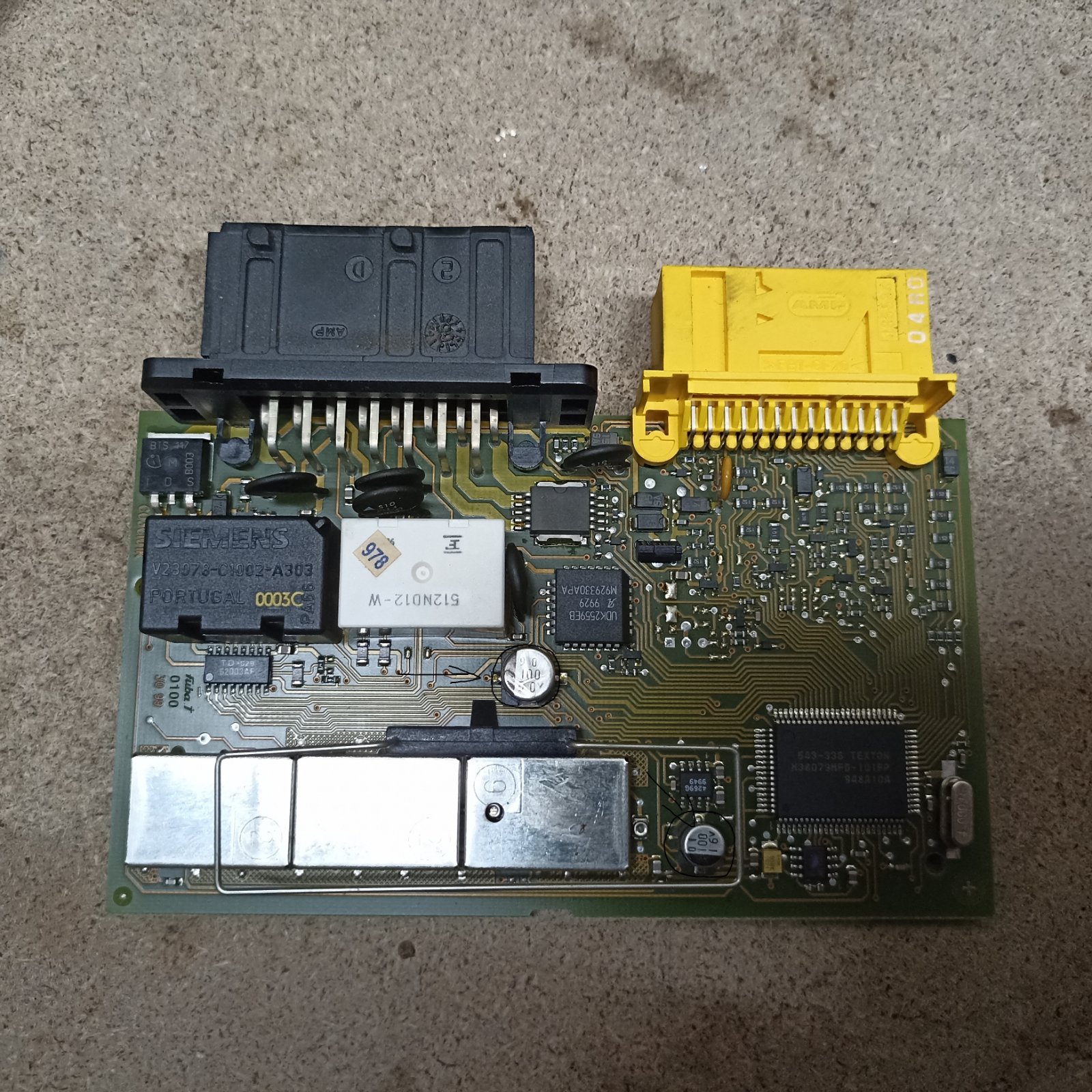

hello my friends from Greece, 3 months ago I had a problem with starting my xantia 2 1800 16v mod 2000 car, the starter was turning but the engine wouldn't start, I had no indication on the dial of a problem immo also when I unlocked the doors the interior light came on and it turned off immediately whereas normally it should stay on for about 30 seconds also when I opened the doors I had the interior lighting flashing and you could hear the relay from the texton cabin brain all these symptoms with outside temperatures below 7 degrees, the same symptoms also happened to a xantia 2 activa of my friend. started, the temperature inside the vehicle had to reach about 20 degrees
this is the problem, gentlemen, its solution
there are 2 smd type electrolytic capacitors on the board with characteristics 100uf 50v and 100uf 16v
change them at someone who has an electronic workshop and the car will never have a problem again

Can you please add a photo showing these capacitors ?xantiamanolis wrote: 19 Mar 2023, 07:58
Thanks
Zohar

look the slim black line

Can you please mark the capacitors on the photo
Thanks

lancia58 hallo look please the previous foto zoom this foto and look the slim black line

Hi xantiamanolis,
The photo is very helpful - fantastic in fact! Many thanks!!
Can you advise - or point me to instructions - as to how to remove the Central Protection Unit/Body Computer from the car, please? Do I need to remove the passenger side airbag? My car is Right Hand Drive, so the Body Computer is on the passenger's side.
