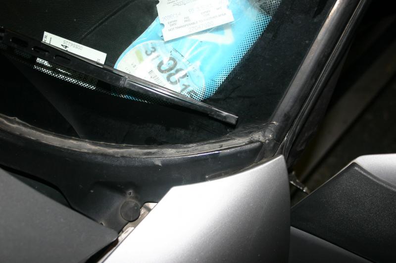

Chris, finally found the picture of the lump of mastic..
It's critical as it diverts water running down the A pillar away from the heater intake...

Haven't got anything like that Jim.. I'll have a try with some silicone tomorrow and see what happens.
Thanks for the photo,

My scuttle is really well sealed with sealant as you can see in the photo Jim I can't see any water getting in there..I've sealed all along the top of the scuttle and it seems to have a good hold on the screen as well as the scuttle.
I'm going to have another look at the aerial base again tonight and if its wet .. I'll know for sure.

Chris, it's water running down the rubber gutter moulding on the A pillar that causes the issue. It exits the gutter moulding just under the wing edge and under the plastic scuttle panel.
If that blob if mastic is not there as a guide under the scuttle the water can flow into the intake...

Naw .. it just looks a lot Mike.. but its definately sealed!!
