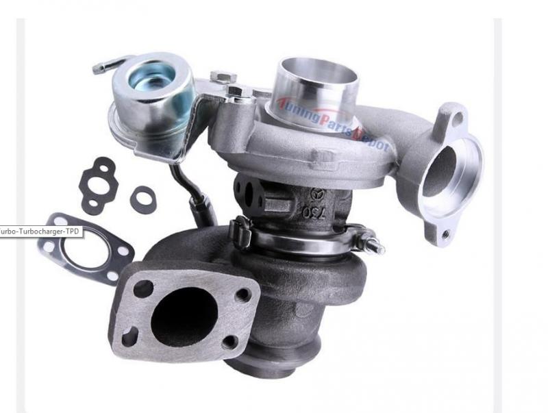

tomthered
- Posts: 124
- Joined: 06 Jun 2006, 22:42
Re: Picasso and EGR valve
Quick update, Will has kindly looked at the car, diagnostics run and discovered the Turbo is knackered, so needs a new one. he tells me there is a set procedure for doing this and from what I can remember its a drain oil and change filter. Clean out the rubber pipe from the bottom of the Turbo with petrol to ensure no crap. Remove a gauze filter from a tube on the top. Change coolant put Antifreeze in, especially this weather. Drive in for 500-1000 miles then change oil and oil filter again. Is there anything else I need to do guys?
- Posts: 12560
- x 1484
Bugger Tom.... not the best time of the year (been there done that, I did it in Jan this year!). I've written it somewhere, but here goes again... Yours will be a bit easier as no DPF, so no pipes, so it might be possible to remove the heat shield without removing the radiator, but be prepared to do it!
Remove the heat shield (one bolt behind the alternator is awkward!) - on DPF cars, there is not enough room to do this with the rad in place, so it has to be removed.
Remove the two nuts holding the the cat on, disconnect the two exhaust clamps top and bottom (undo the bolt, then stick a big screwdriver in the clamp and twist it to release it), drop the cat out the bottom. Buy a pair of the proper pliers to make this easier!!!
Remove the oil feed pipe, unbolt the turbo (you need an e-spline socket
), disconnect the vac pipe, wiggle the oil return pipe off and lift the turbo out.
Turbo can be rebuilt DIY with a new core from e-bay for about £120. Check that the VVT mech is free, and springs back easily.
Before refitting, drop the sump (easy enough, the two long studs at either can be unscrewed with an e4 socket, and this will pull the sump off (no gasket, uses RTV sealant), clean it out. Drop the oil pick up, and clean it out - following repeat occurrences of blockage, remove the screener in the bottom. Remove the vac pump (under the air pipe at the NS of the engine). check for crud in the oil inlet filter, and evidence of bits coming out into the cam hole in the head. If at all suspect, remove the cover and inspect internals, and replace pump if in doubt. Change the oil filter, refit it all. Make sure you remove the filter in the end of the oil feed bottom banjo (it's very small!) - this alone will ensure you never have a repeat of turbo troubles (you may run out of oil pressure, but that's another story....!). Put it on a diet of 5k oil changes and all should be OK....

tomthered
- Posts: 124
Richard - I have just spoken to Citroen when pricing the Oil Feed pipe and they said they replace the banjo bolts and washers. What are they for or is it just a precaution and is it worth doing? What pliers are you referring to and what are they for, removing the Cat? What is an E spline socket and an "e4 socket". As the Oil Feed pipe is £33 is it worth cleaning or is it best replaced?
It would be my son in law who does this, if possible. He has the snap on tools and other stuff so I will ask him but thought I would ask here first. Just wanted to make sure I have everything before it is started. I assume its a couple of hours job, or am I too optimistic? Have already purchased a turbo replacement so no need for a cartridge replacement (don't know whether I fancied that anyway). As for the small filter, When Will showed me it seemed to be on the top on the right of the Turbo, I am assuming that is not the case. Also if the sump is removed what is RTV sealant?
I am sure he said the other day he has replaced one of the on a Ford (not sure what model) and he said it was easy. I don't know whether he went through all this procedure to do it so will check. Also I will definitely be changing the oil changes to 6000 at the most from now on.
The heat shield appears to have three Allen Kay type bolts on the top, I assume there are more? Sorry for not knowing this lot, as you can see I am not an expert!
Below is the one I ordered, which comes with some Gaskets. Do I need anything else? Citroen quoted me £6 per banjo bolt so can I buy them elsewhere? Oh one last thing, Will told me to drain and replace the coolant water, whats the reason behind this? Apologies for all the questions.
Edit: fixed the picture for you Tom...RW
