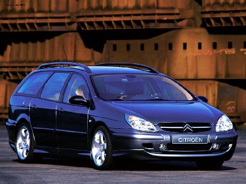

i will reply morrow guys heres somehing i will leave u wiv :)
http://www.motorbase.com/uploads/2006/0 ... c_2405.jpg
