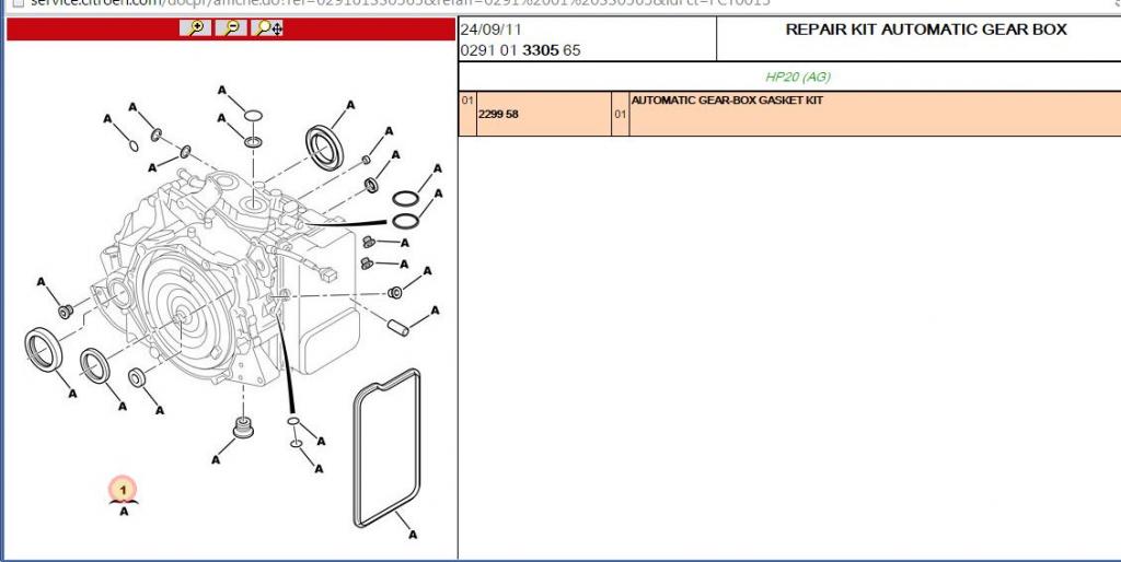

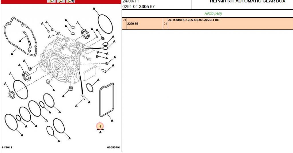

Looks like they quoted for these which are full seal / repair kits, rather than just individual seals:
Part Number Description Quantity Price excl. VAT Price incl. VAT Total incl. VAT Selection
0000229955 GASKET KIT 237.92 GBP 285.50 GBP 285.50 GBP
0000229958 GASKET KIT 112.69 GBP 135.23 GBP 135.23 GBP

£11.82 worth of seals and gaskets when placed in a red/white bag becomes
Pure MAGIC
I've had to order a pack of 10 x 2212.17 seals and the rest in the required pairs
So I get LOTS of red/white bags, winning - even on packaging
Pure MAGIC

Gearbox>repair kit automatic gearbox :
Actually I would venture that neither contains either the banjo washers or the pipe seal at the other end
PS the pipe is a surprisingly reasonably £30

Quite shockingly, you're right Richard..RichardW wrote: Actually I would venture that neither contains either the banjo washers or the pipe seal at the other end![]()
I've not used that kit in rebuilds due to the cost of it. Individual seals can be got from automatic transmission specialists as I've not had the situation where most of those seals can't be successfully re-used...
The big paper casing gaskets are surprisingly dear... About £25 as far as I can remember.
