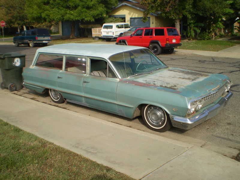

Ooh...have to admit to being as interested in that as the Renault! Have a bit of a soft spot for BMC metal (I blame NSA240W, my first decent road car, a MiniMetro HLE in Snapdragon yellow), and would love to have an Ambassador on the fleet.
Mate of mine had one which I borrowed for a weekend a few years ago and it was one of those rare occasions wher driver and car just meshed perfectly. Just like with both my Saab and my Xantia...can't see either of them ever being moved on.
My own vote is go for "sympathetic restoration" in general...laquer over rust is a step too far for me. Like my approach on my Xantia (a 200K mile car) I don't mind her having some battle scars, provided that it's plain that effort has been made to tend to the wounds. There's a balance to be struck, but "Rat Rods".seem to be becoming too common in my humble opinion.
If that's your thing I mean no disrespect! That's just my view.
