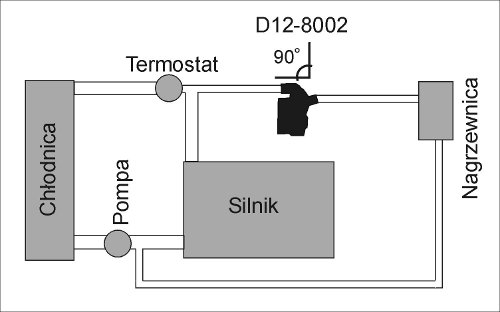

Well it arived last Saturday.. a week after ordering it. The first thing that struck me was just how small it is.. I expected it to be at least twice the size it is.That makes for much easier installation.CitroJim wrote:As far as I can remember on the HDi Chris, the hose that connects to the RH side of the heater matrix connector is the flow from the top of the engine (via the thermostat housing) and the LH is the return to the bottom of the engine so on that basis and to follow how I believe it works normally the circulating heater needs to be installed so it pushes hot water from its flow side toward the RH side of the matrix so that it flows firstly through the matrix and then flows around the bottom of the engine water jacket back up to the thermostat housing and back to the return side of the heater...
So in the diagram below silnik is the engine and nagrzewnica is the heater housing.
So If I've got this right I could install the preheater just above the gearbox below the turbo and air intake pipes. That I think would be after the thermostat and on the right hand side of the heater matrix looking from the front.
Does that sound right?

Re: Water preheater- need hose size
Chris,
Is it sitting between thermo stat housing on engine block and matrix ie bottom half of split diagram
Kenny
Kenny it looks as though the hose I was talking about siting the pre heater on is no 7. Is that the thermostat housing with the wires coming out of it? (inside the red) I had thought it was at the other end of no7 attached to the engine?
If you're correct then the pre heater needs to be mounted on the short tube no 11.
Any commments from the experts?

Just wanted to say I'm very interested in how this works out for you. My HDi Xsara has no auxiliary heater (glow plug type or diesel powered eberspacher), and I have to admit that in the depths of winter I usually start the car 10 minutes before I set off on my 5 minute drive to work.
I know that even in summer I get 40 MPG at best until the engine warms up, compared to 50 over MPG when it's warm. It might become cost-effective to pre-heat the water before setting off in the morning using mains electricity all year round if the pump/heater you have does the trick.
The thing I'm not sure about is how well the water will circulate through the engine-driven water pump. I'm hoping you will find that even though the impeller isn't going to be 'pushed' round by the water flow, the water will still find a way through. I don't know much about water pumps though.
Having said that, is the diagram correct? The Pompa (pump) isn't on the "chlodnica" (cooler/radiator) circuit. Or is it?
