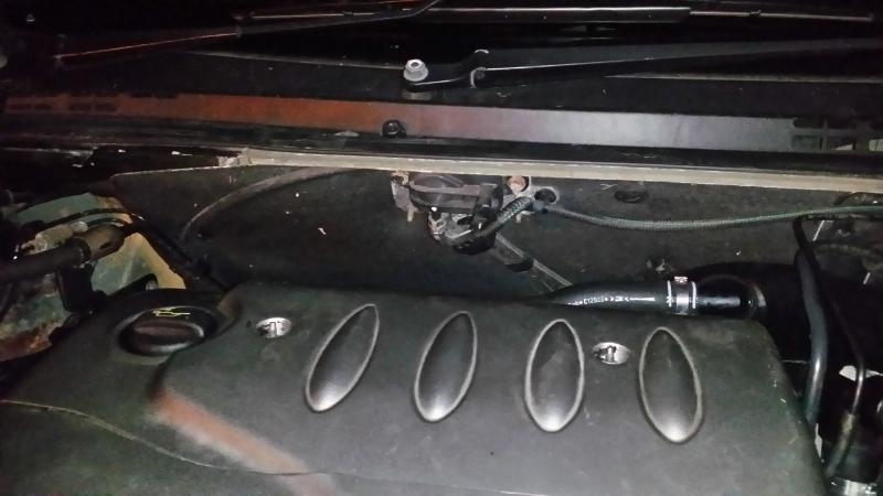

Well I will be d@mned I found it!!! lol
and as it seems it is the same design as the 1.6HDi and 2.0HDi
I kept looking behind the fusebox and kept seeing those little barel type ones... (4 in total)
And then I found it ... just in the middle of the bulk head!
Shall remove it tomorrow and investigate.

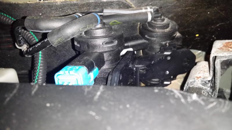

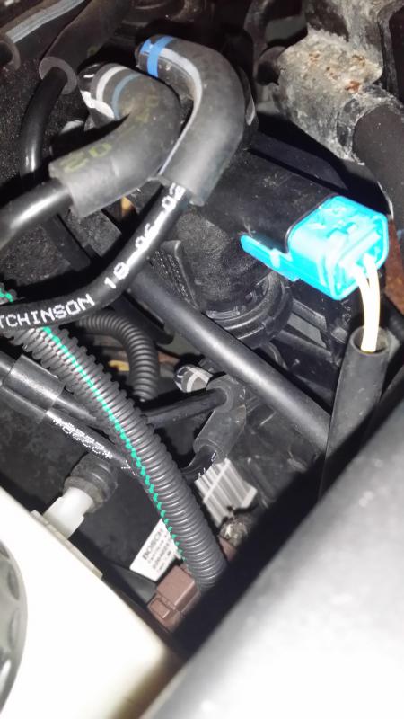

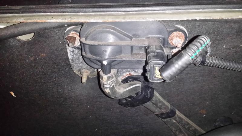

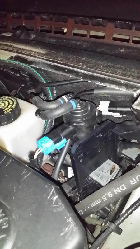

OK so been out this morning and under the car, the pipes all seem to be connected OK (the ones on the DPF are metal and bolted on) and the ones on the Dif.Pres.Sensor are rubber with a clip securing them.
So I blew in the pipes and they are not clogged up ... all ok there.
I then investigated the sensor a bit... and cleaned what I could, put everything back in together (I tried to put the pipes the other way around and idled the car and ... surely EML came up with loads of faults, cleared them and put the pipes the correct way.)
So installed everything back... erased any faults they were there and took the car around for a spin.
It kept reading 0.0mb .... until I reached more less over 4000rpm and then read 5.9mb!
So I assume the sensor is a gonner ...., if the DPF was hollow it will show 0 ... no matter what I guess.
