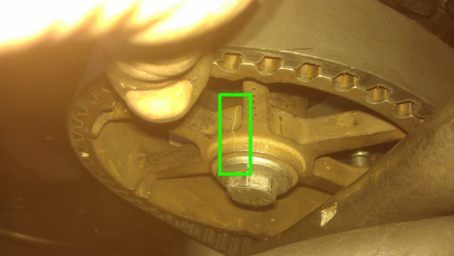

This is now driving me crazy...decided to refit the timing
belt strictly to the haynes manual, that is lock up the
engine, cam and flywheel...done. fit belt working from the
crank pulley - idler - pump and finally cam sprocket, hold
the tensioner off until you have done all sprocket / pulleys.
Now this is fine until you find that the belt is half a tooth
out on the pulley (see photo) so do I a) try to loosen the
8mm locking pins to allow it to reach over the tooth or b)
leave the belt with an inch of slack between the cam and
pump? I have taken photos showing how I locked the engine up
using 8mm bolts and belt 1/2 tooth out.
Photos...

macplaxton

As an aside to the problems, is that white hair-line to the right of the thumb/left of the sprocket spoke with five dots a crack
jma

Thanks Macplaxton....well spotted and going to make this the first thing to check this morning. Another day on the xantia!!

that does look like a hairline crack... and definitely something wrong with the belt sitting on top of the teeth like that..hmm
edit 2
i dont see how the belt can fit some teeth and not others.. odd.
edit 2
