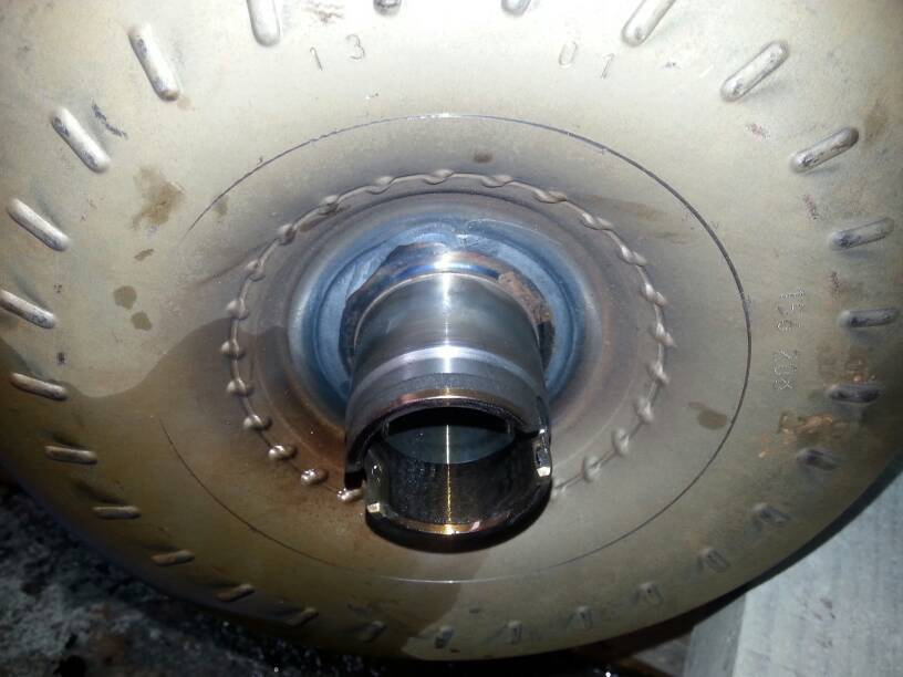

Today I started to remove the gear box from my C5. I took without trouble driveshafts and other componets and bolts. But I can not take out gearbox. There is no enough space, I think I must unmounting the front subframe to gearbox have to come down? Gearbox is separated from the engine 2 to 3 cm, and some oil come down from gearbox.
- Posts: 55111
- x 8406
Re: C5 4HP20
You'll have to lift the engine and gearbox clear so that'll mean bolting the gearbox back the the engine. It'll be the only way but...
You may now find yourself in a lot of bother and problems I'm afraid.
Sounds like the torque converter has come adrift from the gearbox input shaft and that may mean it's now impossible to join the gearbox back to the engine ready for the engine out job.pavlebo wrote: and some oil come down from gearbox.

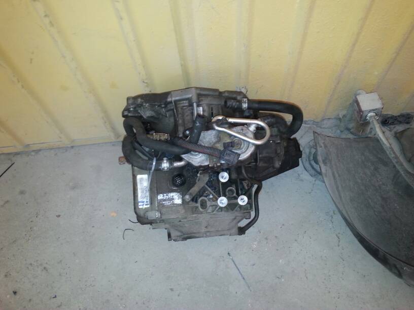

Yes, the torque converter adrift from gearbox and there is not enough space for moving gearbox. I succeeded to insert tool to block converter , similar to Citroen tool.
Now, gearbox is out without removing front subframe.

I will try to fit new gearbox. I have not gearbox refitting rods 8010 and 8010 TA2. I will try to adapt screws to simulate rods.
Old gearbox and torque converter.
- Posts: 55111
- x 8406
Re: C5 4HP20
Excellent work!
Yes, you can use bolts in place of the rods with no problem...
