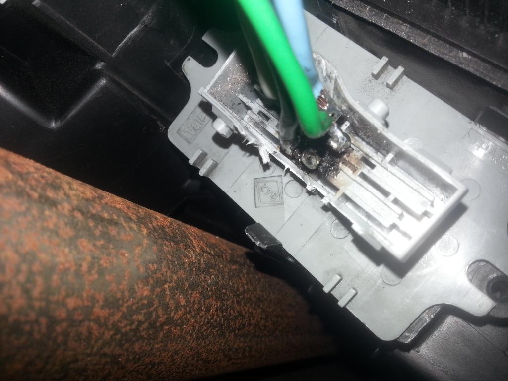

Blower only worked on Max, which in tradition Citroen Style full speed when 0v applied to the control board. The C5 follows suit. I found the blower resister, on low spec cars with air con the resister is on the passenger side, NOT the drivers side as on Climate control dual zone systems.
So, upon removal I found this..
Further investigation for replacment showed that the dealer recognised this "Melting" as a know fault, as they issued a replacment resister WITH replacment and re designed plug, which you then have to cut the old plug off and solder the new plug on.... Cost? Well on ebay 65-70 quid.... :shock: Uh uuu.. NO Thanks. Theres little wrong with this resister im sure.
So this morning, I decided to clean up the pins on the resister and cut the plug off in the car and solder the wires on directly..
Nice good strong soldered joints here, making good low resistance joins should ensure a better life. Result! Yes, a nice 4 speed blower fan now... another job done.
