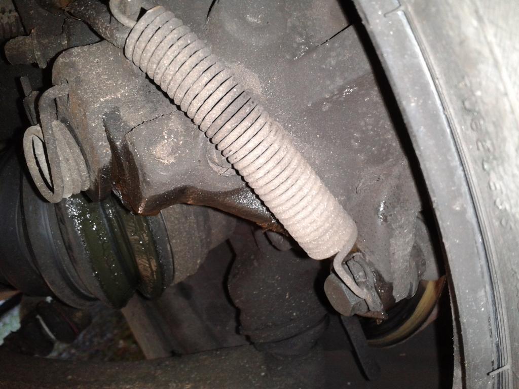

Waynedance, Photo below just before I cleaned off excess plusgas I syringed into the caliper. Finding the right size springs is the problem. I had a couple of suitable springs from the shed so cant advise on where to buy, I did consider deck chair springs but they were too short, on my car the other caliper has the same length spring but slightly thinner gauge.
Under the lower bolt holding the caliper on I put a thin oversized washer with a lug again something from a tool box (or you could use a thin strip of metal with a hole drilled) and then connected the spring between the hole in the washer and over the caliper lever. Its own pressure keeps it in place. IMHO the original spring set up is not fit for purpose, e.g. the main outer spring is actually loose and not under any pressure at all before the lever is back fully down. Good luck.

Photo inserted into Jeff's last post.

waynedance wrote:Just been looking on ebay at springs to use for the mod to the calipers.
Email sent...
I will have to do this mod to sons o/s/f calliper on his 05 C5 VTR. This calliper was replaced about 18 months ago, don't really want to replace it again. As an idea, some of the springs for side and mainstand on motorcycles are rather beefy. The spring on the sidestand on my EN 500 Kawasaki, could hold the QE3 against a dockside,
How do you get to syringe plusgas into the handbrake part of the calliper---is there a hole with a bung there or something??
Also, what is behind the handbrake lever(on calliper)? Is it just a cam, or will hydraulic oil pour out??
I would like to take that part of calliper apart and try to clean it up and use a better grease
There are two sizes of calliper for his C5- one smaller and cheaper---the other larger and a lot more expensive. No prizes for guessing which one he had to buy, lol.

Its a Cam, the only area with fluid IS behind the Brake piston/pads. Hand brakes completely Mechanical

My o/s caliper hand brake keeps sticking and only changed it 16 months ago. Just added an extra spring will see how it gets on.
