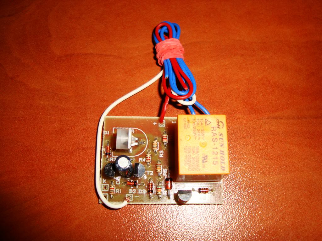

Fail unless you fit one of these http://www.ebay.co.uk/itm/TIMER-SWITCH- ... 1034452865" onclick="window.open(this.href);return false;waynedance wrote:Air bag light on is an MOT fail but would pass if bulb removed.
ONLY ever as a temp measure until the part can be found

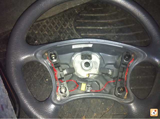

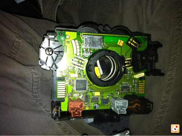

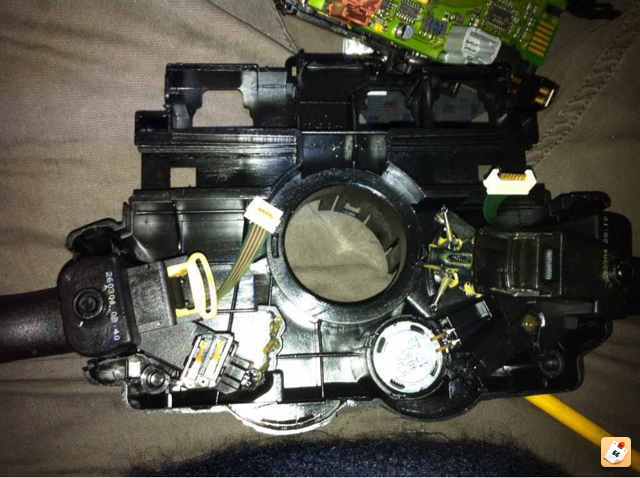

I spent about 4 hours dismantling and reassembling down to the innards of the Com20000 unit. Why'd it take so long? 2 hours was spent at the first effing hurdle. 2 spanners Haynes!?! I wish! The clips that hold the air bag in place are fairly ok to unclip individually, but get one out and the other just hibernates. Oooohhh, the new and novel swear words I managed to conjure up solving that ruddy nightmare. Here's a pic, should you meet them in a dark alleyway, please stab 'em in the kidneys for me:

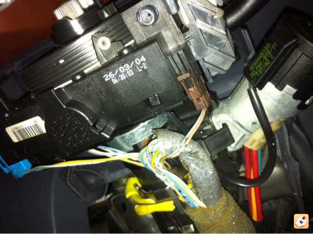

Anyway, I finally got the steering wheel off. The black earth cable seemed disconnected, giving false hope of curing my problem:

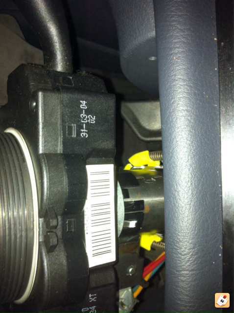

A quick underside. Is it me or is the Com2000 unit younger than my 52 plate car?
Seems that's the case!

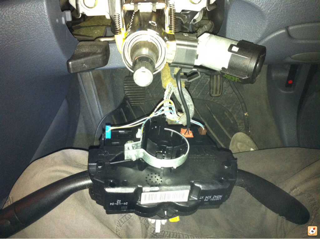

Com3000 finally off, further hope because the brown didn't seem to be properly connected:
Dismantled:

I wonder if the dates shown are the expiry dates (both of the warranty and of the part!).

You'll want the Comm 2000 not the airbag.

If you post up the last 8 digits of the VIN we can check for the part numbber - there are LOTS of variants! However, in your fourth picture you can just see the end of a number ending XT - this is the part number you should be able to cross reference this with potential donors.

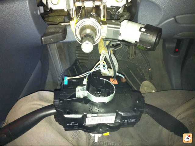

Cheers everyone, luckily I took another photo of the Comm!

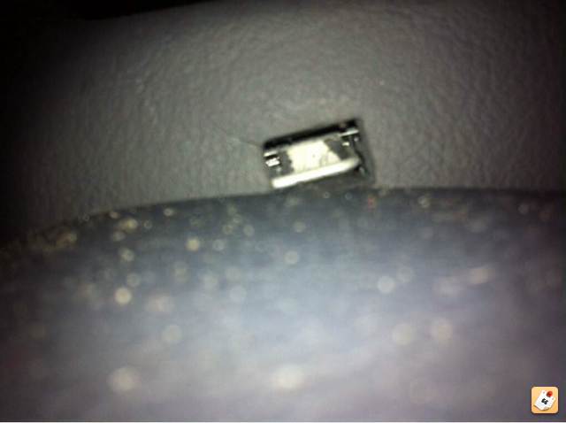

Apologies for the groin shot!

Looks like it's:
122731 70
96542 534 XT
122731 70
96542 534 XT
