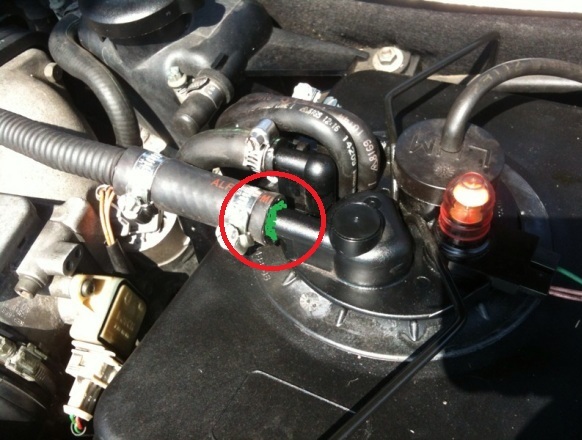

Some weeks ago I noticed the joiner stub on the inlet line to the hydraulic pump was weeping (the V6 has a joiner stub at each end with two hose clamps unlike most other models) and the ride was a bit harsh then - I couldn't get the clamp any tighter so I replaced it with a new one and moved it to the end - this seemed to help for a while, the weeping stopped and the ride became a lot less crashy for a couple of weeks but it has returned:
I think I have a serious air leak again, and I think its probably happening at one or both of the joiner stubs - because the wall thickness of the hose (cord re-enforced high pressure hydraulic hose) is far too great for the clamp to squeeze on - no matter how much the clamp squeezes on the outside it can't cause the inside of the hose to clamp securely and mould onto the spigots. Here is the same joiner hose at the tank end of the pipe:
As can be seen, its quite thick walled and stiff stuff. Can anyone suggest where to get some more suitable hose that is still 1/2" ID but has only a modest wall thickness and is a bit softer so that it will mould more readily to the contours of the spigots when clamped with the hose clamps ? The original Citroen stubs are a kind of injection moulded rubber, and quite pliable by comparison and maybe half the wall thickness.
I think its best if I replace these two stubs of hose before throwing any money at spheres because even if its not the whole problem there is certainly a LOT of harshness and crashiness from air at the moment which needs to be sorted out first.

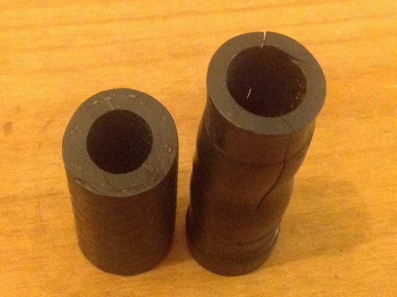

Here is a picture of the original stub hose from the tank end of the inlet hose (the pump end is the same on the V6 as well) and you can clearly see the much greater wall thickness of the replacement hose on the left:
Inside diameter of both is 13mm, (the original is stretched at the end making it look bigger) outside diameter of the original is 19mm while the replacement is 22mm. I believe the wall thickness and stiffness is too great to allow the hose to mould to the shape of the spigot properly, no matter how tight the clamps.
I'm searching online to see if I can find a better replacement than the one on the car now, I'll post the details if I find some.

Problem is I think its the pump end of the hose leaking and you can't get at the pump end of the joiner with a finger to smear anything there, and it would melt and run away due to engine heat anyway.
I agree about small jubilee clips, but we're talking 19mm - they're usually ok. I think its just the hose is too thick and stiff to mould to the spigot in an air tight fashion - at least not long term, as it was working well for a while but then started weeping again. Enough of a leak to weep oil is certainly enough of a leak to suck in air under suction.
The hose itself is corrugated but the joiner doesn't clamp down directly onto the outside of the hose - the hose actually has a moulded plastic spigot at each end that looks like this:
It has two slight bumps at each end with the clamp presumably meant to go between them. I've found some hose I like the look of here:
http://www.desihose.co.uk/viewproduct.aspx?pid=1135#" onclick="window.open(this.href);return false;
12.7mm ID (so slightly snugger than 13mm) 19mm OD (same as the original) and it only has polyester yarn reinforcement - many of the other pipes they stock have wire reinforcement etc which would make it too stiff.
It also has the lowest bending radius of any of the 12/13mm hoses at 90mm, which I take it to mean that its one of the softer hoses they stock, but is still rated to 120 degrees C. Should be perfect for getting a good reliable air tight seal so I've emailed them to find out what their minimum order is. (No reply yet)
Because the V6 pump spigot is 13mm as well as the tank (the pump on most Xantia's is 10mm) I could even use a single length of that hose all the way from the tank to the pump with no joiners - at least as a test. It couldn't be routed across under the engine cover like the original due to the tight bend radiuses.

isisalar wrote:Re Simon's post regarding air leaks in the tank to pump feed line. I replaced mine completely prior to doing the o rings in the pump, and it seems to be working perfectly. Also did same on the old VSX.
The elbows on the pump end and elsewhere are certainly weak points and trying to copy the original pipe run is almost impossible. I can only speak of the HDI and the 1.9 td but in both cases by re routing the pipe it's been a very simple and effective job. In both cases the elbows are completely unnecessary. Here's a couple of pics of the HDI.
https://www.dropbox.com/s/m5ttpnehfvrr8 ... .30.49.jpg" onclick="window.open(this.href);return false;
https://www.dropbox.com/s/t4npuk0jyuihu ... .31.11.jpg" onclick="window.open(this.href);return false;
On the HDI the tank end spigot is just a little too small, by less 1mm, to give a snug fit in the 1/2" fuel grade tubing readily available, so I built it up a little with a bit of PTFE tape, was going to use amalgam tape but the hydraulics place the bits came from recommended the PTFE. This is also used, internally, to seal the aluminium to brass reducer, necessary for the 3/8" tube going on to the pump, this was a good fit on the HDI. Obviously jubilee clips where necessary.
There's even a handy hook on top of the rad to tuck the pipe into and cable ties can be used to support if needed. I left the original pipe in situ, can always use if the other's leaking.
I originally tried Pirtek for the bits but they were unable to supply a suitable joiner at all, as luck would have it, next door to Pirtek were these guys http://www.hopespare.com/" onclick="window.open(this.href);return false; who had the bits to make up a good joiner,were cheaper, and a lot more helpful. They're only down South but may do a postal service.
Not sure if this would work on the v6 but hopefully this may help anyone whose Xantia feels like a skateboard over little bumps. Do the pump o rings as well, very easy too on the HDI, and all else being well, it will transform your car.
Cheers
Paul

Thanks Paul, it looks like you used Pirtek hose ? I don't suppose you have the part number for the larger diameter one at the tank end ?
I don't really want to replace the entire length like you did however - just the stubs at the ends. There are no right angled joints on the V6, just formed bends that allow it to run neatly under the engine cover.
