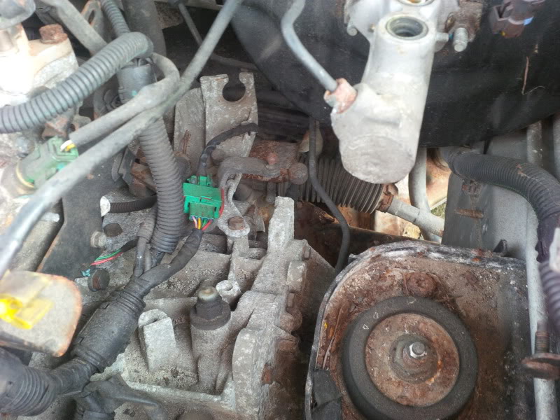

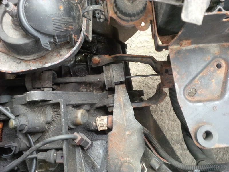

nipped up the yard in the village yesterday, Plenty of french options int here for box's, from Base model early 306 to 07 plate xsara, (with most inbetween!) i did howver notice one or two had an Odd clutch arangment,
is this a Push arrangement??
and not really sure quite what arrangement this is??? all appeared on the back of the box

nop the first picy is a pill/back to front clutch
and i cant see what you think is the clutch actuator in the second picy,
if its a manual box the clutch lever will be more towards the front on top of the box, and along side one of the starter mounting bolt heads,
the same place as the clutch fork lever in the fist picy really

Thats what confused me malcom, was a manual but didn't have Anything in the usual place on the box, no obvious holes where it could have been removed etc. Just seemed Odd!
