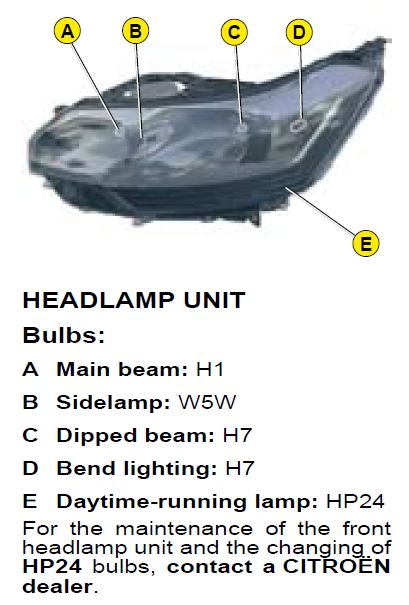

Just had a quick look. Without delving too deeply, there is a cover behind the headlamp bulb which needs a few degrees turn anti-clock, pull it clear and you seem to be at the back of the bulb. The DRL will be a lot more difficult and I suspect the directional bulb will be tight but manageable. Might need to remove the plastic panel at the front of the engine bay for easier access to the side lamp, which is at the top bank of two bulbs behind the inner section of the lens.

Re: Got a headlamp bulb blown on the C5
I've checked in the english language car handbook, here's the situation, X7, regular (non-xenon) headlamps, version 08-10 (not facelifted):
What you said to be sidelamps, I've thought of as bend lighting (english direct translation logic, need to get my car vocabulary updated ...
) ... anyways, as I've said before, I've managed to replace ALL the bulbs, except the DRL's, HP24 ... because I'm still waiting for the led's to arrive ... for the rest, I didn't need any specific tools, just used thin rubber gloves for better grip and to avoid bulb contact with the fingers ... and was done in about 15 minutes with both headlamps ...

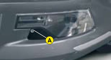

As for the lower part (fog lamp & directional lamp), it should be pulled out, the above picture has a marked A, that's where a torx toll is required ... haven't tried it myself, but that's in theory (and per the manual) ... will maybe get to it if I find a good white pair of foglamps ...
Yep, just had a quick look and I think you're right.vborovic wrote:As for the lower part (fog lamp & directional lamp), it should be pulled out, the above picture has a marked A, that's where a torx toll is required ... haven't tried it myself, but that's in theory (and per the manual) ... will maybe get to it if I find a good white pair of foglamps ......
