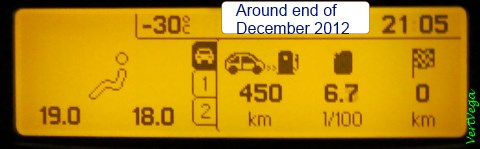

That's correct but there's a minor issue with the temperature sensor of Xantia which shows
only until -30ºC :mrgreen: and below that there is only " - - - " on the display :roll:

Rhothgar wrote:There are not many places that get to -30 on earth.
That's true :) I have taken this pic while driving with my c5 II 8-)

blimey, that's high-tech! newfangled LCDs eh?
Don't think my poor old 1996 xantia mk1 has any outside temp indicators. Closest thing she has to an outside temp indicator would be the thickness of ice I have t scrape of the inside of the windscreen :/
