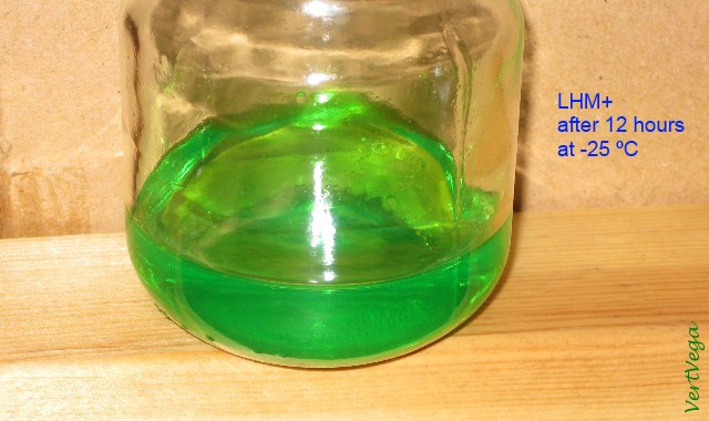

I have taken the below pic after the small amount of LHM+ stayedromie wrote:Has anyone experienced any problems with LHM fluid in very cold conditions?
Say at around -20 Degrees Celsius?
at -25 ºC over 12 hours. There was no visible change in the consistency of the LHM.
The jar I used was a small (~2 dl) baby food jar. At - 32 ºC there was slight visible
change in the transparency of LHM but still it was "liquid"

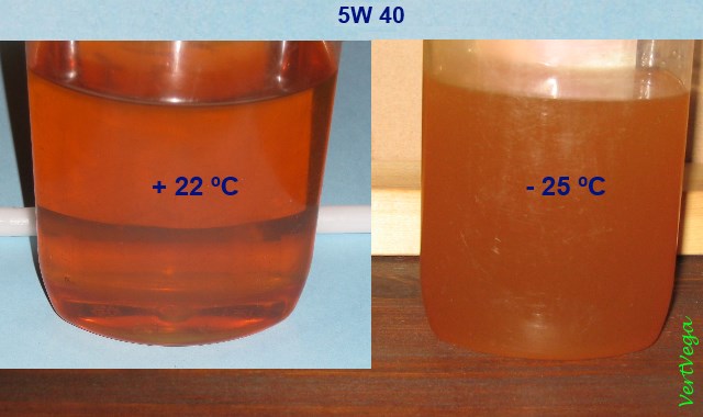

Edit: At the same time I had another experiment going on with the engine oil of about 0.4 l
Fully Synthetic 5W 40 (Total) and the results were as seen below:

Re: LHM in freezing conditions?
Hi VertVega, nice little experiment you had going there
Interesting, so the LHM held up a lot better than the engine oil?
Am I right in thinking you noticed that the LHM didn't change viscosity much.
But the engine oil did get a lot thicker?

I have no idea about diesel engine motor oil grade. I have to ask from my colleagues at work who drive diesel cars. I drove several times with my car to warm climate countries (for example Italy) and engine oil was still 5W40.
At -25 LHM didn't change viscosity at all. Even such a small amount of LHM (less than 0.1 l) kept its transparency, viscosity and color.
