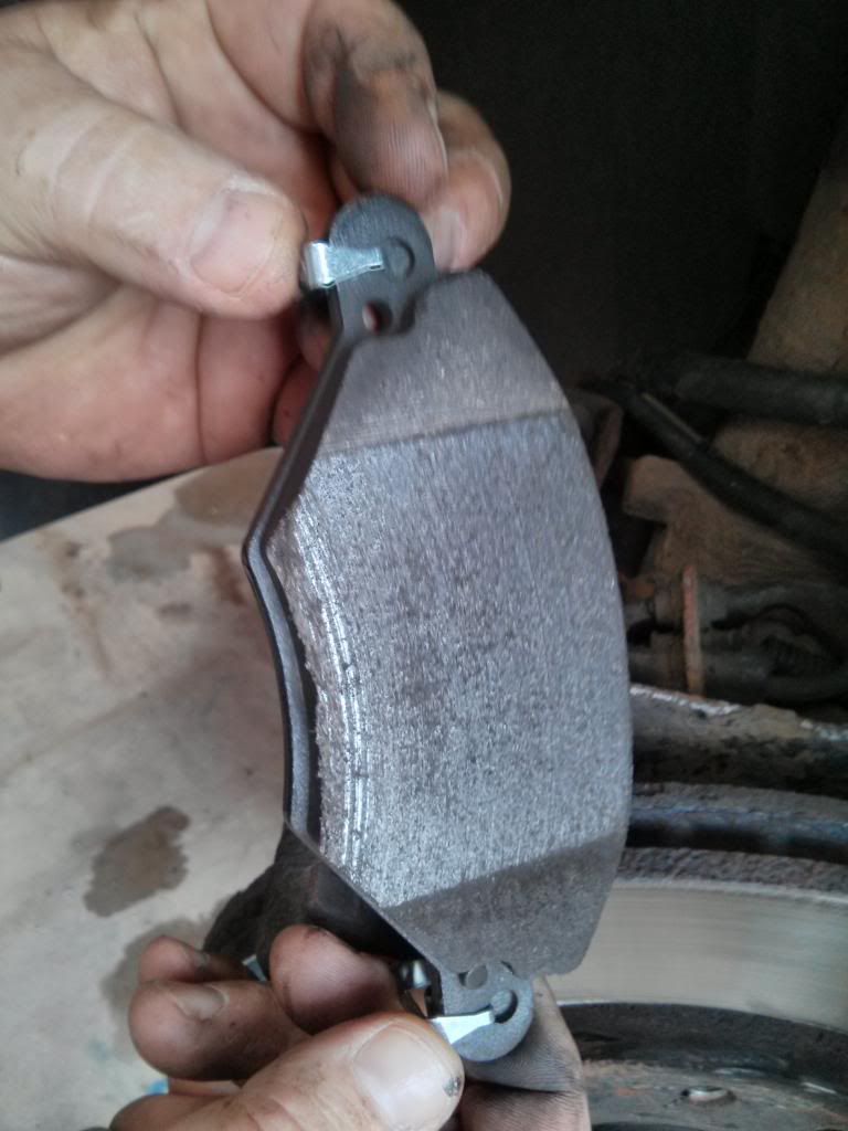

Well in the south of France. I have to admit I worried (as I always do) whether we'd get here. Same problem seemed to exist throughout journey. Was especially bad through France. To recap:
The car seemed to be pushing/pulling against something. As if foot was pushing on brake.
The car vibrates. Not Massively but enough to make you worry.
The wheels on driverside were hot but not scaldingly so but i never touched brake area. The otherside the wheels were cold to touch.
So where are we?
This has only begun since brake blocks were changed alongside tracking rod end. Quick deduction- it's to do with that.
The car ran much smoother after mechanic ground off worn in protruding rim on the disc which had been digging into new pads (see picture) as was some rust around centre.
My feeling. The same may have been happening to the drivers side wheel. I know there is a worn in lip as before as I can feel it but when checked it seemed to move around freely-ish. Doesn't rotate freely but will move around when pushed (I assume this is the brakes normally touching) However maybe after heating up it expands too much?
I do have a flat spot on a wheel and a tyre which has a wobble but mechanic said this wouldn't cause issues. They are on the back now I think.
So will check for lip but don't want to be taking cars brakes apart without supervision or on first day of holiday.
Any thoughts folks? I guess the pad or a sticky brake cylinder are the main concerns.
